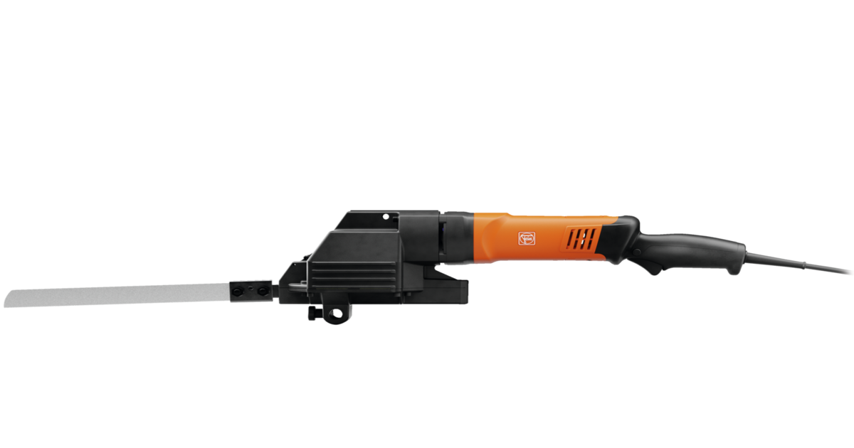

How much do you want to spend?
Fein manufactures portable electric hacksaws that can be used for pipe up to 24” in diameter.
There are multiple clamps that handle different diameters, that tighten like a chain vise on the pipe.
I think the saws are normally intended for higher strength materials, and there is even an I-Beam clamp, but the saws can likely be used for thinner material as well.
There is an electric and a pneumatic option.
Cost is probably several thousand dollars or more once you add the clamps and blades.
Used ones are sometimes on ebay, although you might still need to buy the clamps.
CS Unitec sells similar saws.

A small toothed carbide blade on an oscillating tool would likely do a clean cut as well, but you would need some type of jig to ensure a square cut, and the jig would need to not damage or crush the tubing.
Fein traditionally sold round saw blades for the Multimaster and Supercut tools that were designed for cutting sheet metal, including automotive sheet metal, although the blades were usually a high speed steel alloy.
Diablo, (a brand owned by Bosch), makes a curved carbide blade for the oscillating tools, that may work similarly. (Carbide is routinely recommended for stainless cutting, although high speed steel would probably work, just dull way quicker).

The Kett Saw with vacuum adapter might be another option, but again, you would need a custom jig to keep the cut straight.
The video is 8 years old, and I don’t know whether Kett has added blades for stainless yet.
A toothed blade would be much better, as any kind of sparks will contaminate the SS, requiring it to be passivated if you need it to be rust-free in the long term.
Since the OP mentions this is for food processing areas, I'm thinking rust-free is important.
