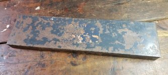

Smokeshow69
8,426
While this is not a “barn find” duplicated tool box, I did create this “barn find” barn door last week! Using similar aging techniques. Wood is new but screws used are truly old
