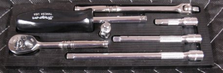

The tooling holders are great. I tried a similar idea a while back for a 1/4 drive set and 3/8 extensions and really like them. I can see what's missing at a glance.

i love the tool trays you have built, where did you source the cutting board material, i just purchased a lathe and milling machine and I think this will be my first project
I have a local Woodcraft that has 24 x 24 sheets of it for $30 (they do have them online too). I haven't been able to find any place that has them for less oddly enough. Most plastic suppliers don't want to mess with the smaller quantities. There is a guy on ebay that will sell stuff called Starboard which is HDPE but I don't believe it's food grade (not that it matters for what we're using it for). The seller's name is acesany. His prices are a little steeper than Woodcraft but he has a variety of thicknesses and colors.
