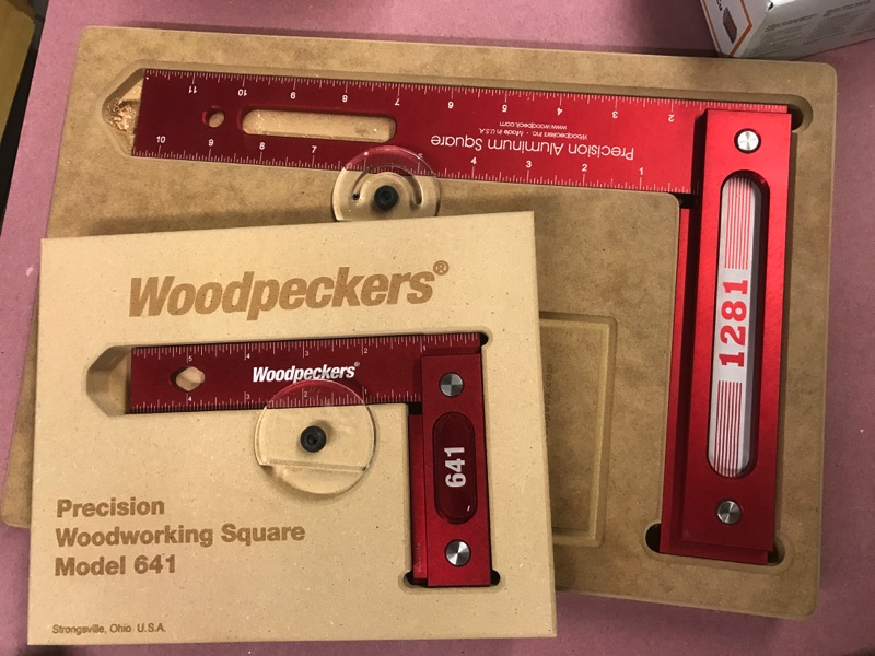

I've always been extremely pleased by the form and function of WoodPeckers tools and the two I might just use the most are the 3 and 6-inch squares.
Last week I got a little something something in the mail. For reference, the small square in the middle is the 3-inch from above.
Now if i can just figure out how to not drop them when using them and how to store them when I'm not.

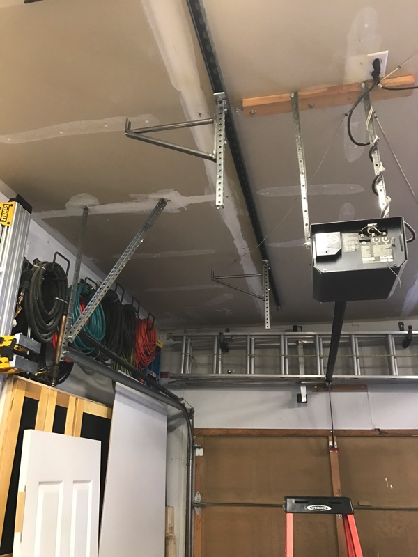

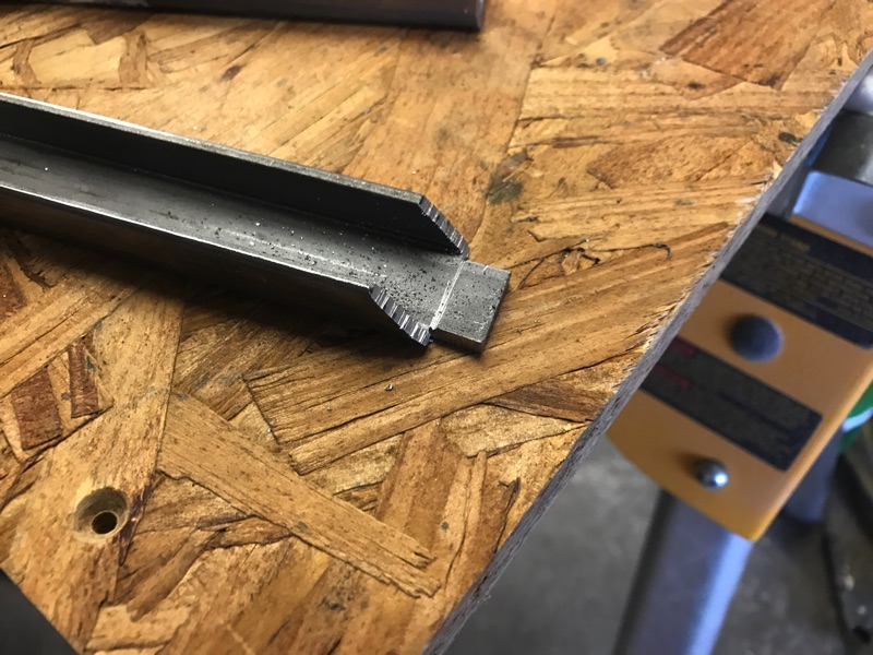

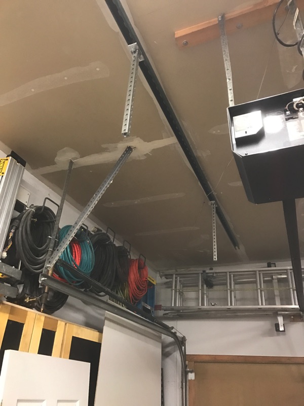

Today I worked on moving the ladders to make room for more cabinets over the garage doors. As Jo Diesel and I were discussing, I decided to take advantage of the unused space above the garage doors which has previously gone unused. I chose to consolidate all of my larger ladder and us as little space as possible. Warning...picture heavy.
One of my goals in reorganizing the garage is I wanted to use as much of the materials I had laying around all possible in the organization effort so i didn't have to store them anymore. All of the cabinets thus far were left-over sheets of plywood from previous cabinet builds. I have 3 pieces of uni-strut so I decided to build off of the longest which was a 12 or 14-footer. The hanger assembly was going to be made out of some holy 1-inch square tubing I've had since forever. I started by welding some uni-strut braces to the bottom of the 24-inch pieces.

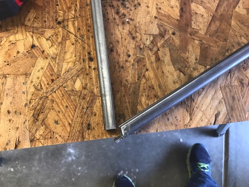

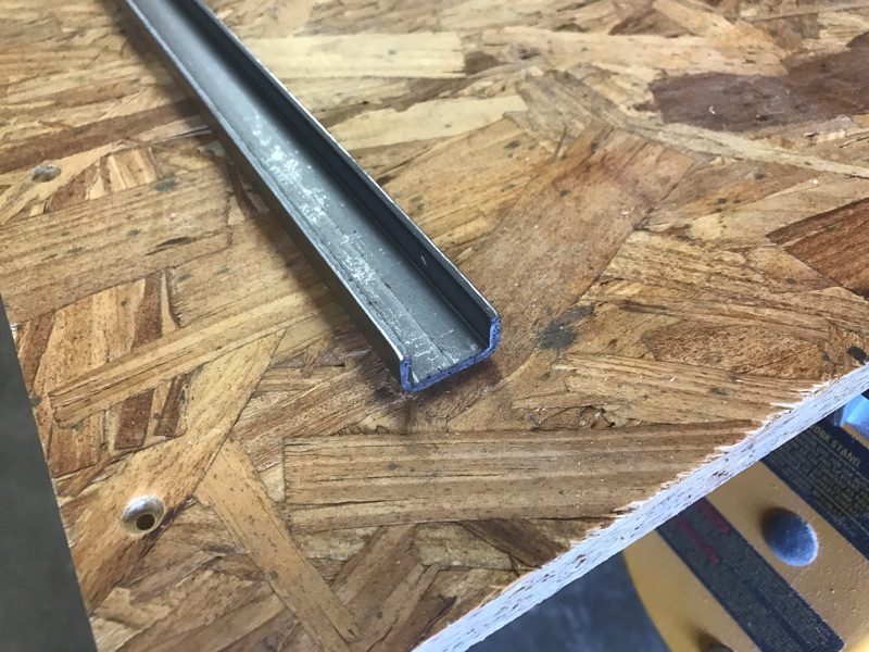

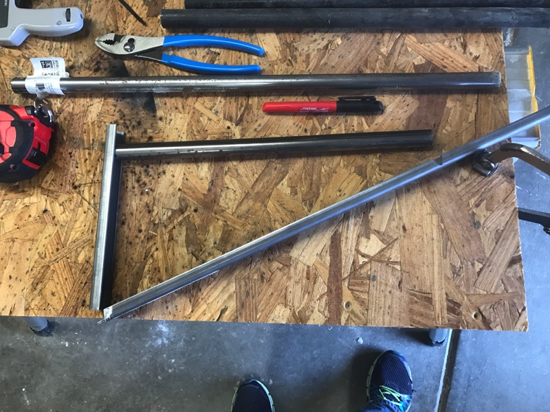

Now it's been probably 3 years since I've welded anything that you'd call fabrication. I know it's been about this long because I realized I no longer have a welding table which is a far departure from what I used to have at the shop - 2 tables that were 5x5, 1/2-inch tops, and clamp and fixture friendly. Since those days are long since behind me, I made a make-shift fab table out of OSB and one of my Dewalt saw-horses. Worked fine but having to attach the ground directly to the item SUCKED. Anyway...after welding them both up and attaching the uni-strut to the ceiling, I was well on my way.
Almost immediately I really got into the metal fab. It was my first true fab skills I developed when I was in my early 20's and every time I get to do even a little, the ideas flood my mind. Now I needed to make some ladder racks. I sorted through my material pile and found some u-channel that I think I originally purchased at HomeDepot.

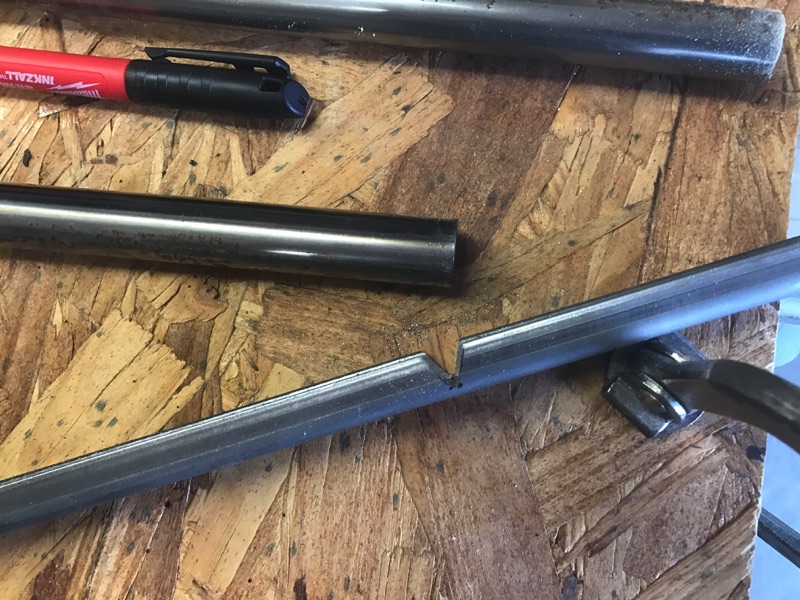

I made an angle cut and then cut the walls away from the channel so I'd have a tongue.
This allows one piece to "french" into the other channel.
Then I gut a V into the walls of the channel about 15 1/2 inches up from the tongue.

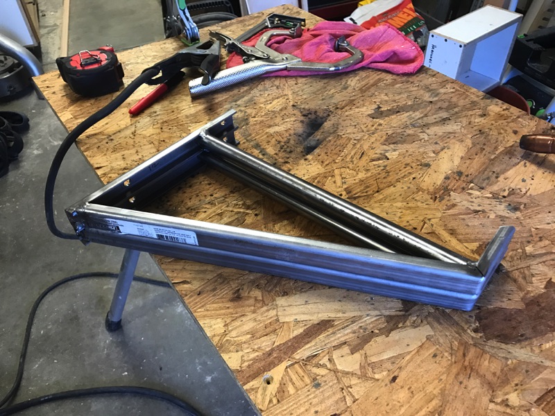

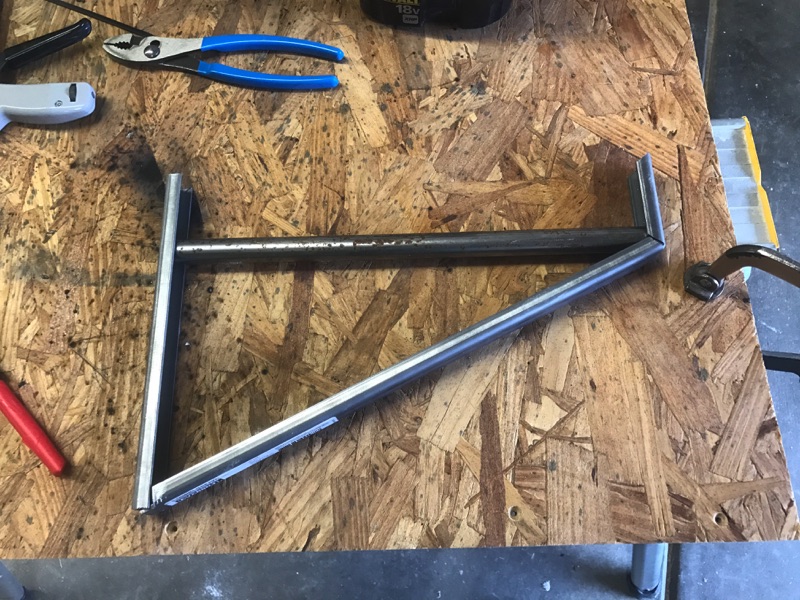

I found a piece of 3/4-inch round tubing (about 1/16-wall) which I'll use for the hanger surface (which the ladders will sit on). Having the hanger surface be round will prevent the ladders from getting torn up while sliding on them.
Now I bend the u-channel where I gut the V-groove to match the angle needed.

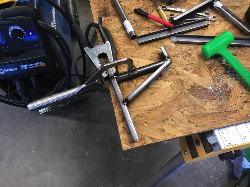

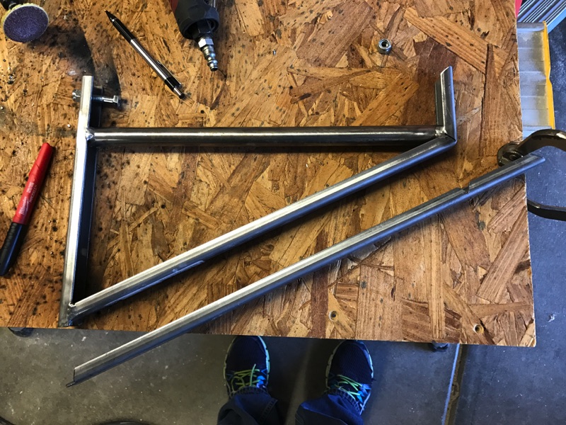

Then weld it up. Now that I know the measurements, I cut up another.
The reason I got into the business long ago in the first place was I really enjoyed being able to make exact duplicate copies of parts (over and over and over again). Somehow I get a deep sense of accomplishment doing so. In this case, I only needed two (bummer).
Once cooled to the touch I wire-wheeled the heat affected zones to remove the dis-coloration (to return them back to the raw metal look) and bolted them in place.

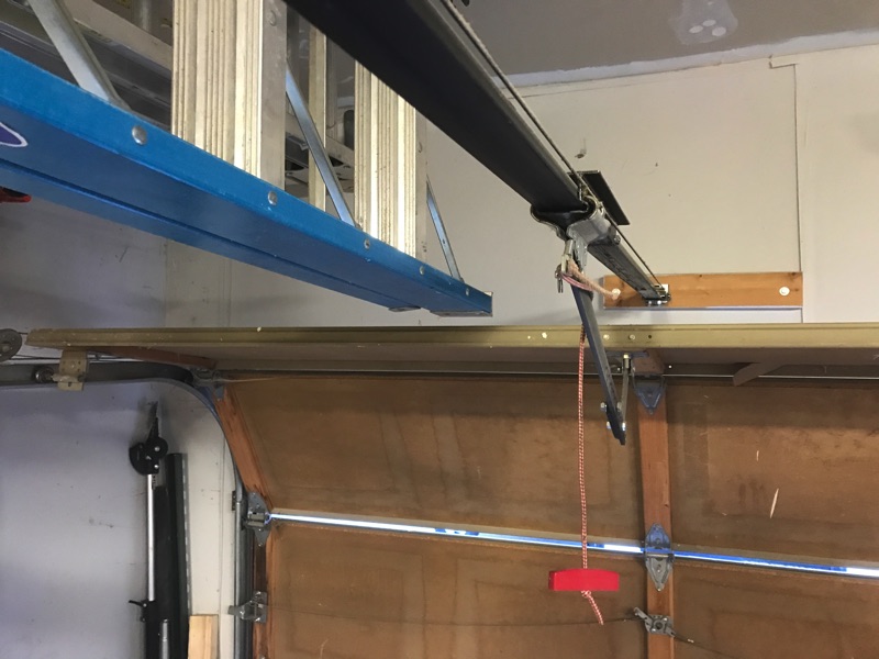

And hung the ladders which had plenty of clearance above the garage door.

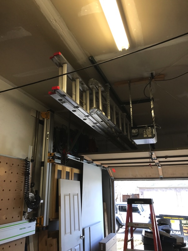

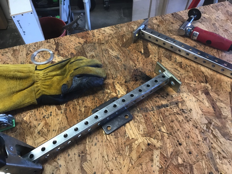

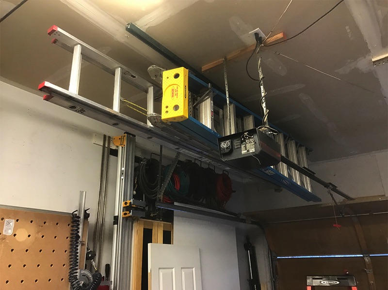

I have one more tall ladder that I intended hanging on the other side of the rack. this one is a fiberglass ladder but has a much more wedge shape to it. I made some smaller hangers with a slightly different offset to make clearance for the taper shape.
Mounted it fits up there really nice and fills all usable space.
As luck would have it, I managed to get the ladder exactly where it needed to be. High enough to make it onto the hanger which just BARELY clears the door. Hard to see in this picture but that's about 1/2 to 3/4-inch of clearance. Fortunately the door tracks are where the door tracks are and will never move. Good enough.
This non-sense took way too long but now I'm ready to continue with the cabinets. Getting close now.
As luck would have it, I managed to get the ladder exactly where it needed to be. High enough to make it onto the hanger which just BARELY clears the door. Hard to see in this picture but that's about 1/2-inch of clearance. Fortunately the door tracks are where the door tracks are and will never move. Good enough.
Difficult to tell in the above picture but I added a brace to the middle of the uni-strut which prevents the uni-strut from pivoting on the lag screws that are mounted up into the stud in the ceiling. Without it, the strut would easily sway back and forth as I loaded the racks. Now it can't move around at all.

Really nice use of available space. And a great step-by-step series of photos.
I was surprised the first two ladders hung as straight as they did. I though they might cause the uprights to lean to one side with the weight. But the other side definitely would counter-balance.
Looks like you have to have a ladder to get those down?!

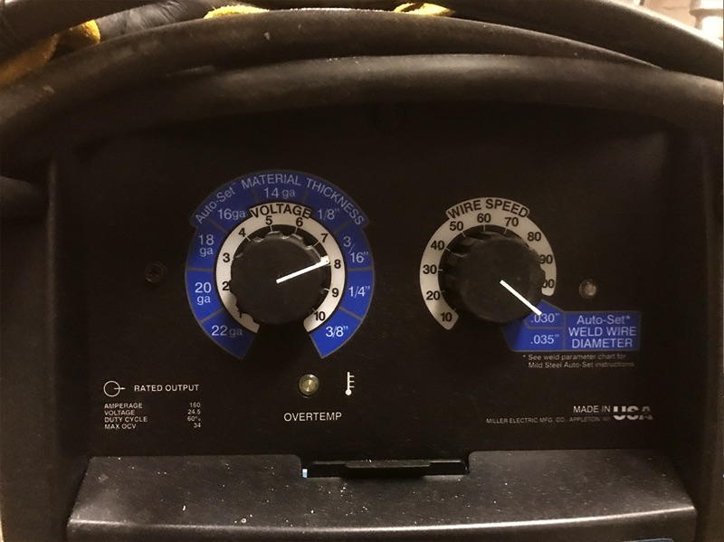

How do you like the Millermatic welder?

I'm on the fence. My last Miller was a MM250X which was more old-school and had wire speed and voltage settings. The more I welded with it, the more dialing it in became second nature. This is a MM212 Autoset version which is supposed to take the guessing work out of it for you (though you can use it in both modes if you like). You select the wire size and then the thickness of material you wish to weld and it's supposed to do handle it all for you.
What I dislike is that the autoset doesn't always seem to find the sweet spot. In many cases I set the material thickness to be one size thicker than what it really is. Otherwise the weld just looks too cold to me. In general I like the machine. It's nice not having to be at one with the thing especially since I don't weld with it all that often anymore.
It hangs almost level. I'm going to add uni-strut braces to the main length that run perpendicular to it and prevent it from racking as much. I just couldn't spend any more time on it today. Will have to wait until next weekend.
Yes, I'll have to use a ladder to get them down. For the blue one, I can get it down with my 4-foot ladder easily. The other two I'll have to use my 5-foot ladder. I use the 4-footer daily and the 5-footer once a month. These ladders on the rack I use maybe twice a year which is why there up and out of the way. If i need a ladder to get them down, no biggie.
