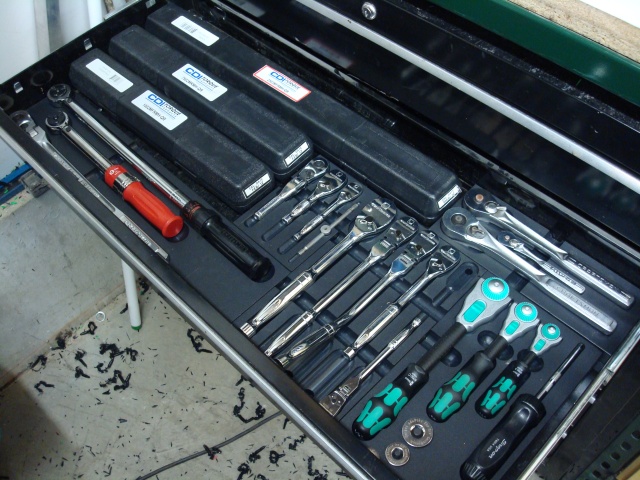

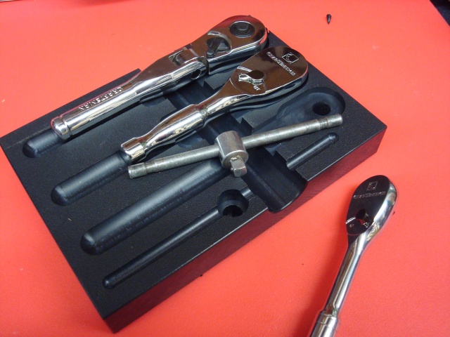

I'm sure everyone is getting tired of watching me machine plastic. I'm getting a little tired of doing it. Instead of throwing out all of the pics from today's time in the shop, I'll just share the final pic of the completed small tray
...and the completion pic of the ratchet drawer.
It's time to drag everything away from the wall and start cleaning up plastic chips. They're everywhere.
Howdy! I read your thread a couple of years ago, when it was still mostly fresh, but I felt the great desire to re-read it today after going through some other epic threads here on GJ.
I just had to say that this picture, and all of your storage trays, make my brain happy. That is something that rarely happens, unless everything has its specific place! Thanks for sharing!

Trenton,
Thank you! I completely agree, of all of my drawers, this one is the one I like to pull from the most and, as a result, nothing ever finds itself out of place.
To date, my second favorite is my pliers drawer.
Matt
