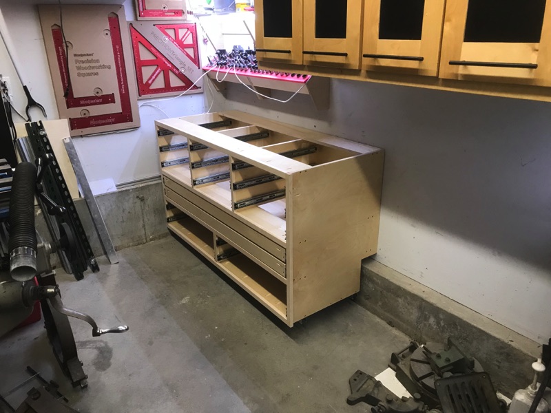

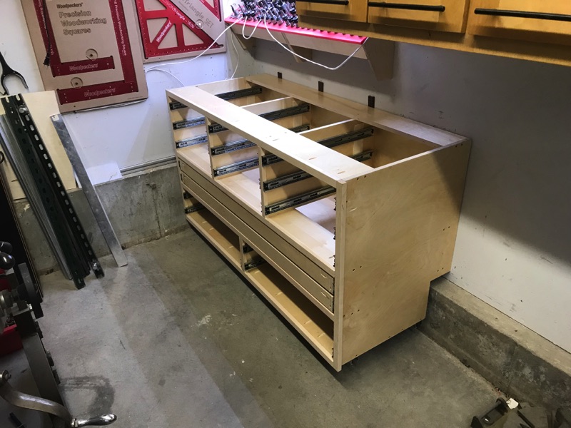

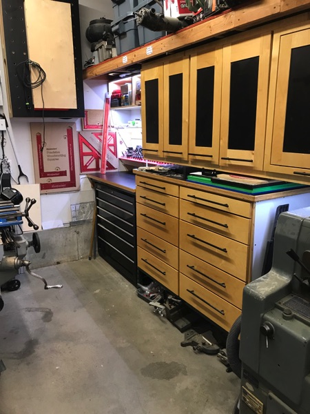

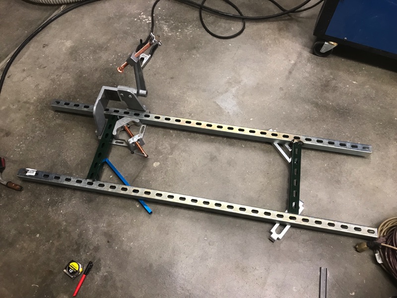

Preparing for the new Tooling Workbench

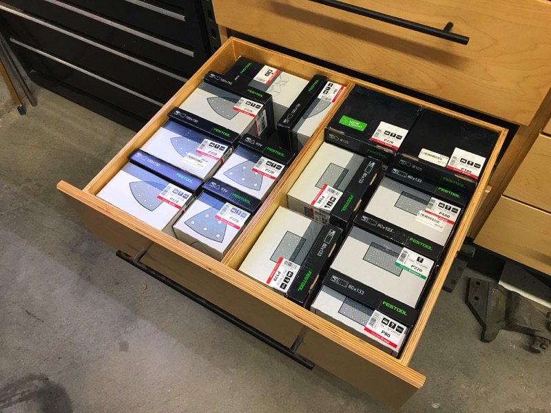

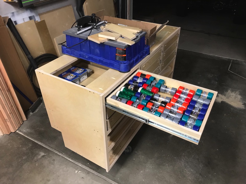

Though not finished, the primary workbench construction is done and it’s usable again. It’s tempting to move all the tools in however I know that unless I have most of my storage built and in place, moving it will just cause me to do it again…and I’m in fab mode, I might as well finish. This weekend I shifted my focus to the other side. The existing bench and cabinets are currently setup like this. I’ve really liked this space but learned that the bench is too small to really use it for more than tooling setup and I rarely actually do tooling setups.

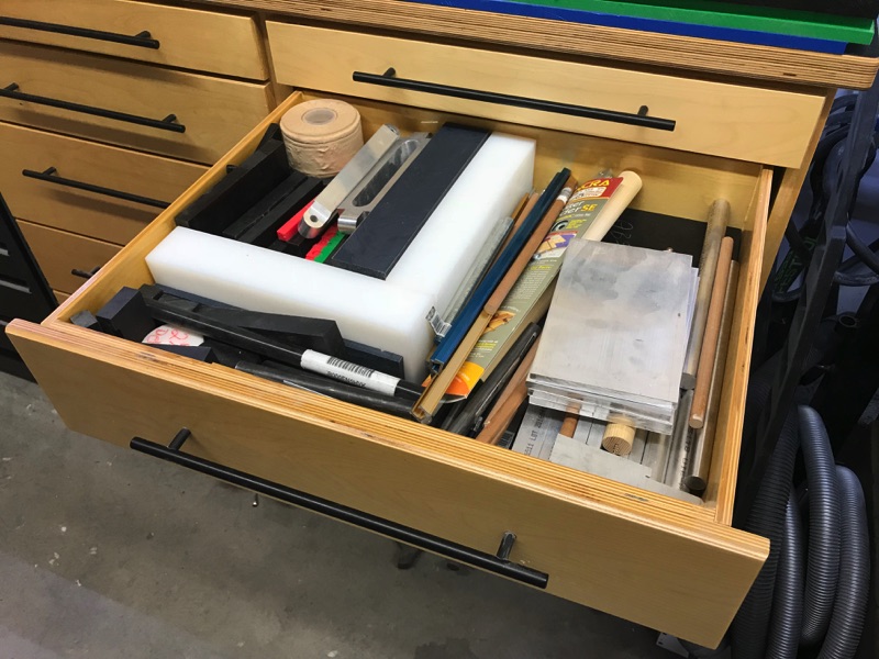

Originally these drawers were used to store tools but, as I’ve shifted to festool tools and added a SysPort setup out in the primary garage, these drawers have shifted to more of catch-alls than anything else. It was actually these drawers that got me thinking about my overall organization strategy. I don’t need to pile stuff in deeper drawers but I do.
Sometimes it’s useful however. Drawers like this make material drops easier to find quickly however I really only want a single drawer like this, not multiples.
The reality is this - I can find much more efficient ways to store sandpaper (I have 3 drawers full).

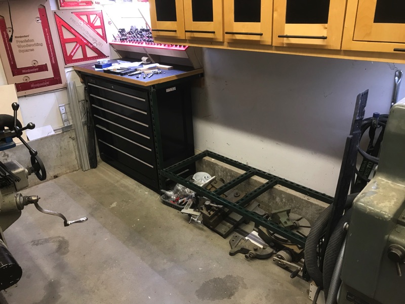

With so many of these drawers seeming unnecessary, I’ve had thoughts of how to use this space more effectively. Size wise, this space is nearly perfect for storing my Kapex miter saw and one of the MFTC’s and still leave me some room to elongate the tooling bench so it’s more multi-purpose. While elongating I’ll also gain more drawer storage so I can store the things I really need to store for easy access. A longer bench will also enable me to have a really long drawer for the stuff that was too big to fit in drawers before.

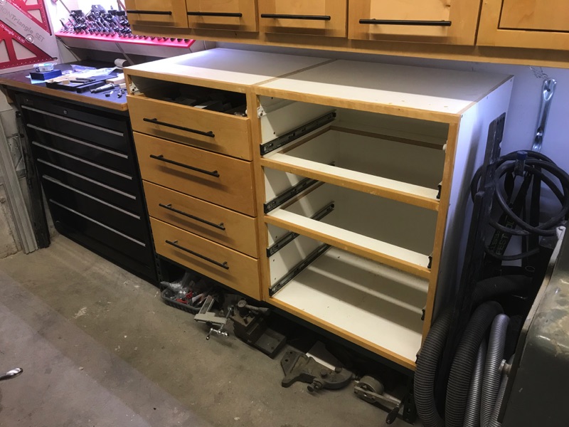

So, I’ll clear the space in preparation for the new setup and start with the drawer-bases. As I begin to remove drawers I noticed that this cabinet assembly has more structure to it than the previous main bench bases did.
After I get the drawer bases moved, I realize how much I used the space under them for “additional storage”

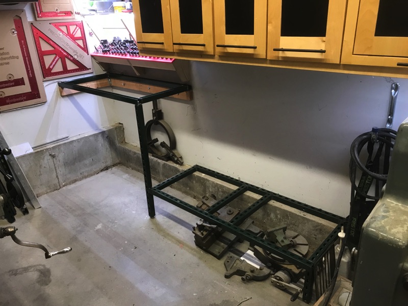

You can also see how I utilized the uni-strut to build out a support structure over the box and the drawer bases. I even cheated and used the foundation to support the backside of the drawer bases. I’ll have to take that into account when building the new cabinets.

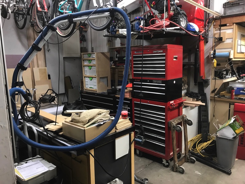

Had to remove everything from the craftsman 41-inch cabinet too. Those drawers were so heavy that I had no choice but remove everything from them one at a time before removing the drawers. With the base out of the way, you can now see the overall uni-strut structure. I think I made all of this out of less than two 8’ lengths. If you have a welder this can be an incredibly effective way to build out cabinet and bench structures (everyone on GJ knows about Stevo’s Harbor Freight benchs…you could use uni-strut if square tubing isn’t readily available).

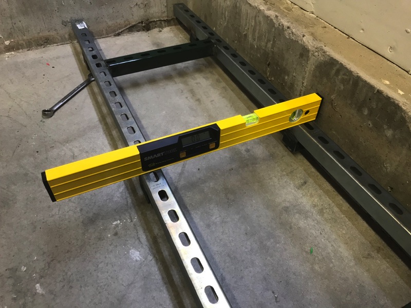

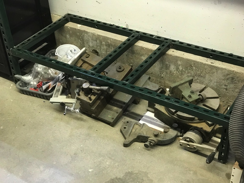

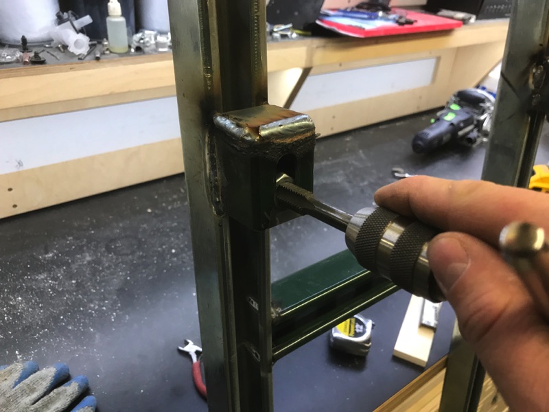

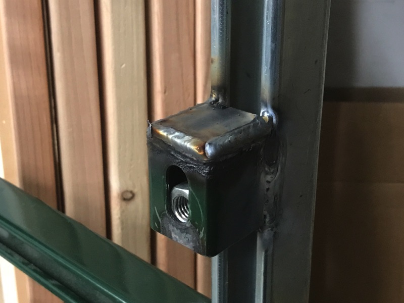

With the new cabinet being much longer than the old one, a new base is necessary. Wood tools move to the side and hook up the welder. The local big-box store was out of the green painted uni-strut so I had to get the galvanized stuff. I hate galvanized. Even though I clean it, it still burns and ain’t healthy to breathe. As for the design of the base, I’m building less complicated than what I pulled out. Cut two pieces to length and some spreaders, drop the hood, and weld away. Having a StrongHand fixture makes tubing squaring and alignment extremely easy. It ends up square, it just does.

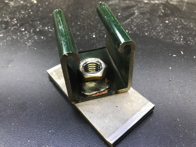

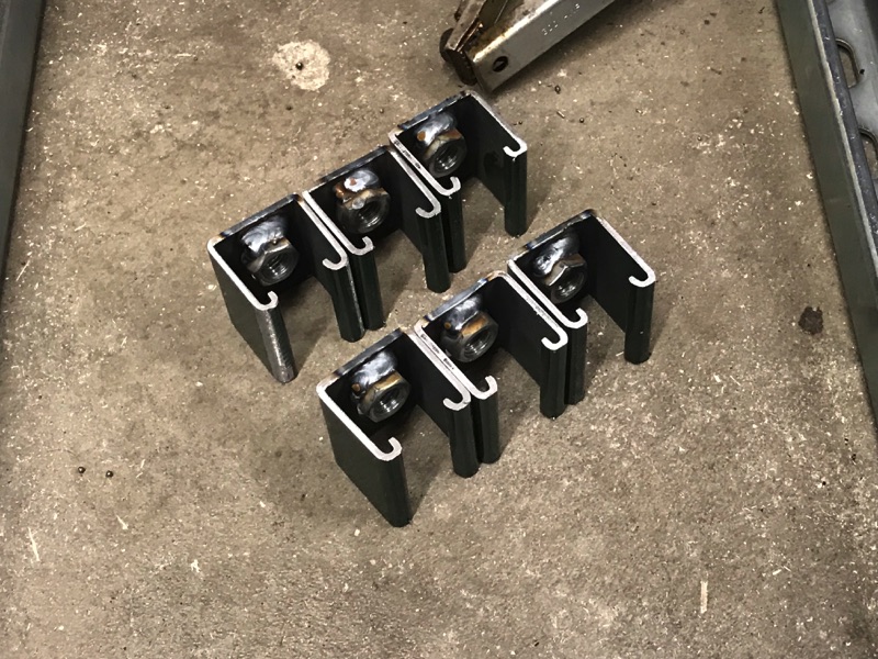

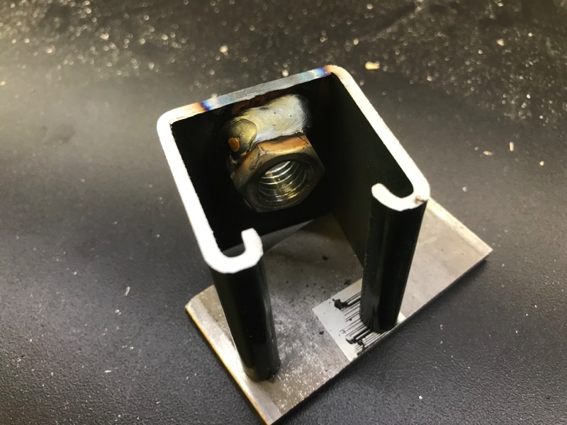

Here’s how I make the feet. I cut a bunch of uni-strut pieces about 3-inches long (I cut perfectly in between the slots so whatever length that ends up being). Then I run a 1/2-inch bolt and nut in the hole and weld the nut into the edge.
I keep the nut off-set so there’s material to weld it to.
Fairly quickly I have a set of 6 (with no additional trips to the hardware store ;)
After welding them on, I stand the assembly on end so the heat can risk up through the material. If I were to lay it down on the floor, the heat would rise perpendicular to the material causing parts of the assembly to cool at different time than others and I’d end up with a warped piece of ****. I learned this trick from a guy who first showed me how to narrow 9-inch ford rear ends.

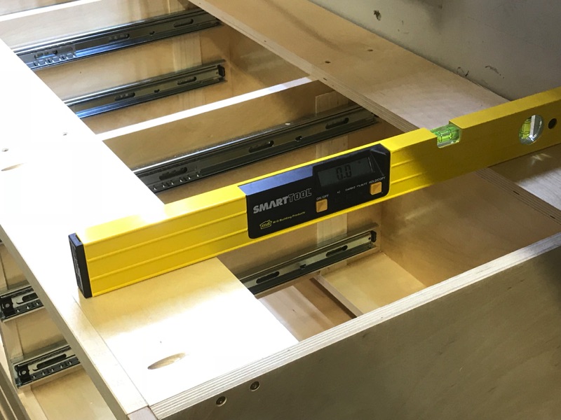

Back to the cabinet base -The only concern about using uni-strut for feet is that too much weight could cause them to collapse so I add some plate/gussets to the outside of all of the feet.
When pushing the nut/bolt assembly to one edge of the uni-strut slot, it sometimes gets so close that the bolt has a hard time threading into the nut so I re-tap all 6. Only takes a second and makes leveling later much easier.
With the assembly complete and is cool to the touch, I level the assembly using the outer 4 feet. Once I have it level, I spin down the middle two until they touch and then a smidgen more. Final check for level and tweak as necessary.
Since the base isn’t physically attached to the floor, I mark the front two feet with a sharpie on the concrete so I know where it’s supposed to be on the chance I bump it while setting the cabinet on top. If I don’t, I will be nearly impossible to drop the box on without re-leveling (unless I get lucky)

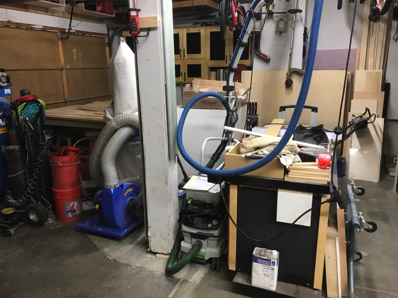

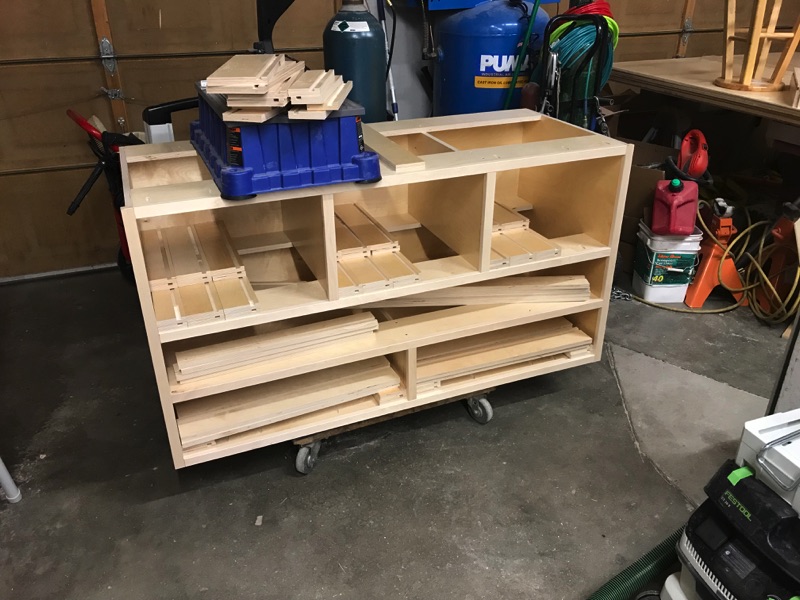

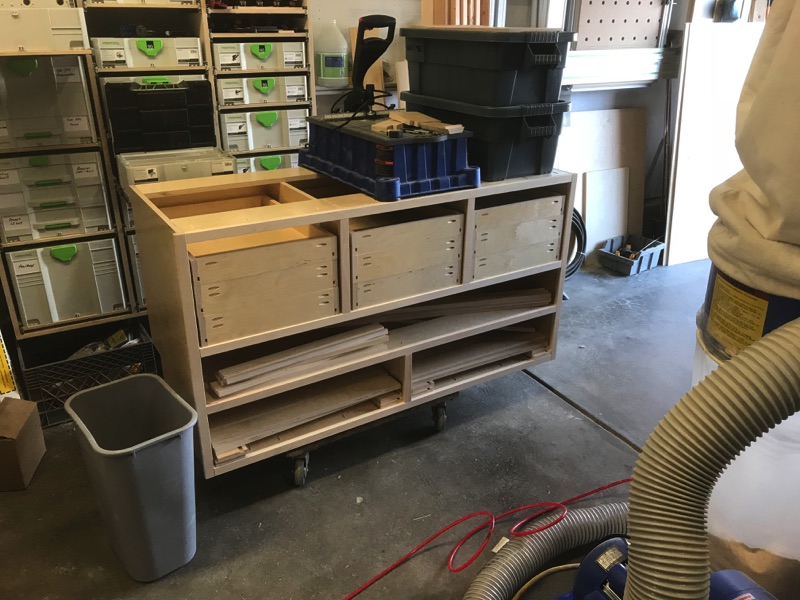

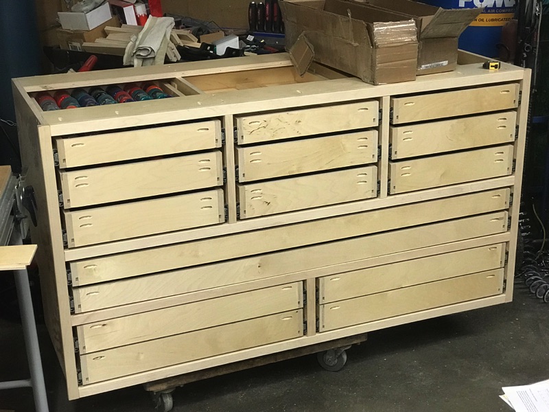

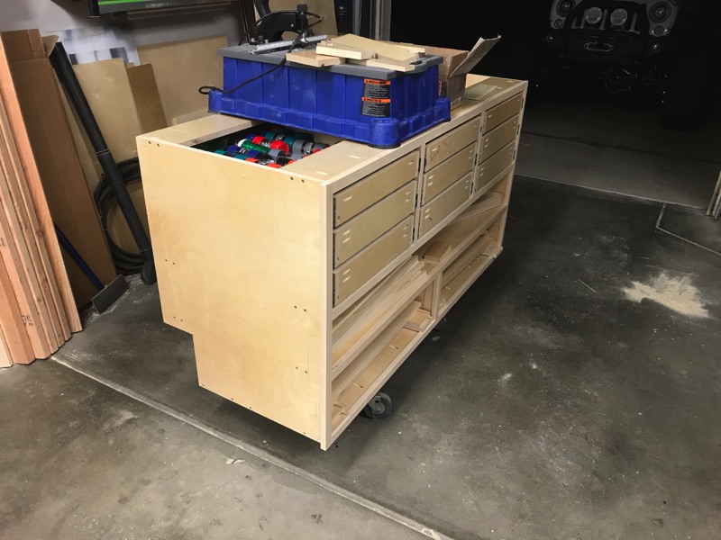

I thought I'd get into the tooling bench this weekend however I spent way too much time moving things from one location to another and then to another again when it was in the way. The back of the shop is already starting to look more open but now everything feels messy.

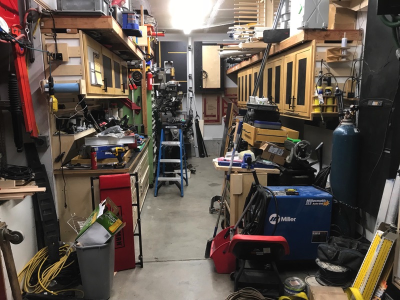

The 41-inch Craftsman tool chest is back on wheels and now lives between the table saw and the cabinets in the front of the non-tandem side.
The front of the non-tandem side gets to be temp-storage-ville. All of the 5x5 sheets of plywood are resting on my two MFT Horses which easily slide directly into the saw when I'm ready to cut. I have what's left of the previous cabinets resting on two different dollies so I can roll them around as needed and then tuck them back in the walk ways during the week so I can still get the Jeep in the garage.
Next week I plan on getting the tooling cabinet put together and build some more drawers. Can't wait to start moving things in. Maybe I'll lead with that next week.

Here’s the finished tool bench assembly. Before everyone goes all armchair gangster on me, no, I did not build this in just one weekend, I did it in less than a day...seriously. All components were pre-cut at the same time I machined the main bench so it only needed to be assembled and it helps to have a drawing and all the parts labeled waiting for you.
With the box complete I was back to building drawers again. This time I had all of the measurements documented so the day went a little more bang bang bang than before. Set up the miter saw stops and it becomes a little easier to fly through the assembly. Since there were really only 3 different sizes, it was easy to knock out the top 9 as soon as I got the dimensions right on the first one. These top 9 drawers will likely hold mostly hardware and some basic setup and machining tools (like calipers, chuck keys, parallels, etc). All 9 were designed to match the depth of the various organizers I use. More to come down below.
I failed to mention how I decided to accommodate the protruding concrete footer. After measuring I found that it sticks up about 12-inches and out about 5. Problem was I didn't account for that when I pre-cut all of the plywood so I had to go back and "notch" the back after the whole thing was put together. 5-inches must have been lucky when it came to modifying the cabinet because with the 5 removed I can now fit full 18-inch deep drawers on the bottom 4 drawers. All of the full-length drawers were still going to be 24-inches deep which is awesome. Probably as close to wasting no space as I could get.
In contrast to the Craftsman box, it only had 18-inch deep drawers so the added 6-inches will make a huge difference. This shot shows just how much hardware I can fit in a single drawer. I went ahead and loaded a drawer so I could realize the fruits of my labor (aka get some motivation to keep plugging away). As it turns out, they have never left the drawer since I put them in there and now it’s almost too easy to get the hardware I need when I need it and put it back as soon as I don’t. These view-tainers have just about every kind of hardware that I use in the shop. #6 screws in 1/2, 5/8, and 3/4-inch lengths. #7 in 5/8 and 3/4-inch, #8 in 3/4, 1, and 1 1/4-inch, 1 1/2-inch…and so on. I’ve learned that it’s so much cheaper to buy in bulk and have what I need on hand than it is to go to local box store and buy 25 at a time. As for the view-tainers…I keep a small one full of most hardware so I can easily grab what I need and throw them in the toolbox or take them over to the bench for a single use (even assembling a bunch of drawers). I keep the bulk boxes up in longer-term storage.
The weekend wrapped up with a completed assembly. Ran into some challenges with the bottom drawer sets (4). According to the drawing they were supposed to be as deep as the upper drawers with equal reveals (1/2-inch).
I was running out of time Sunday night but I just had to see the bench stuffed back in the corner. To my disappointment, I couldn't manage to lift it off of the dolly onto the base without removing all of the drawers (it was too heavy).
Check to make sure it’s level. Of course it is, the base was level and the cabinet is perfectly square. I really like the leveling feet system. It’s worked so well for me over the years and enables me to re-level the bench should the floor shift (which it has).
Got ‘er shimmed and permanently attached to the wall.
Yeah...so outta time I had no choice but leave it exactly like this...couldn't even drop the drawers in. Good news is that next weekend I'm moving in. :3gears:

The new cabinet looks great. I like your ingenuity for dealing with the footer. If you had a whole wall of cabinets know one would ever know its there. Do you happen to have a link for the viewtainers?
And you are right about the hardware not only being cheaper but better quality than most of the China soft screws at Lowes or HD. Except for the maybe their higher end pro brand with the torx drive or star drive.

I know, I wish he would travel the country and build some nice benches & drawers for my garage! :lol:
You bustin my balls here?! You could build cabinets just like these, skip a bunch of the lipstick steps, roll paint on them, and have a bangin’ space yourself. Cabinets and drawers are so easy.
Huh...have I not documented the steps!? I was rushing through and skipping stuff because I thought it was old hat and it would be boring content. Was I wrong?
