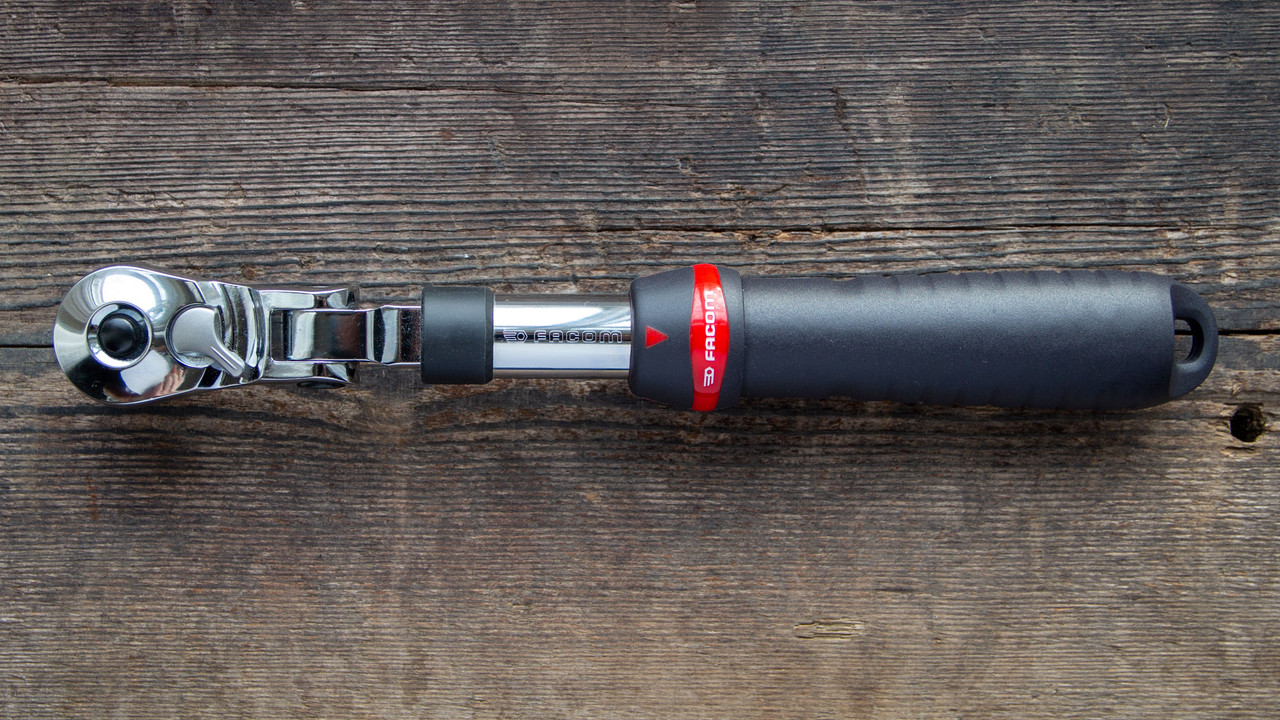

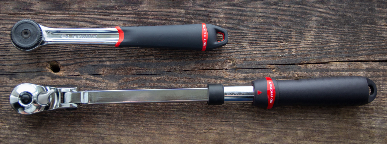

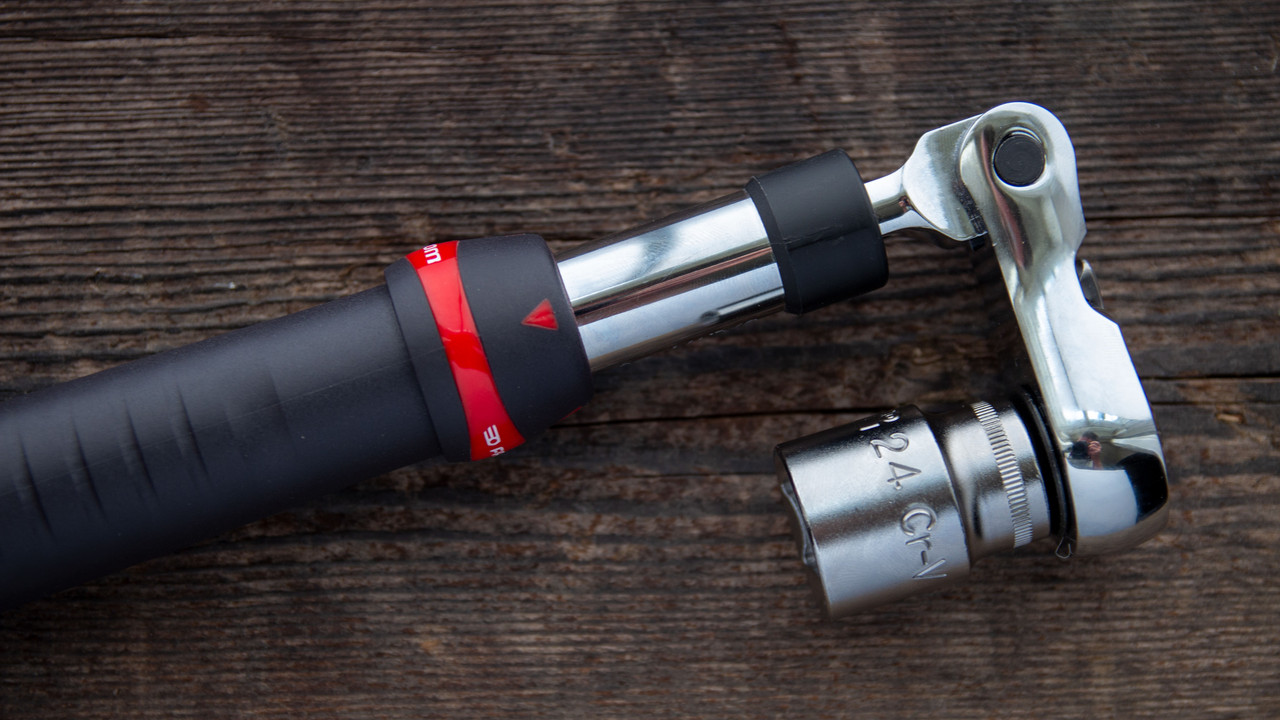

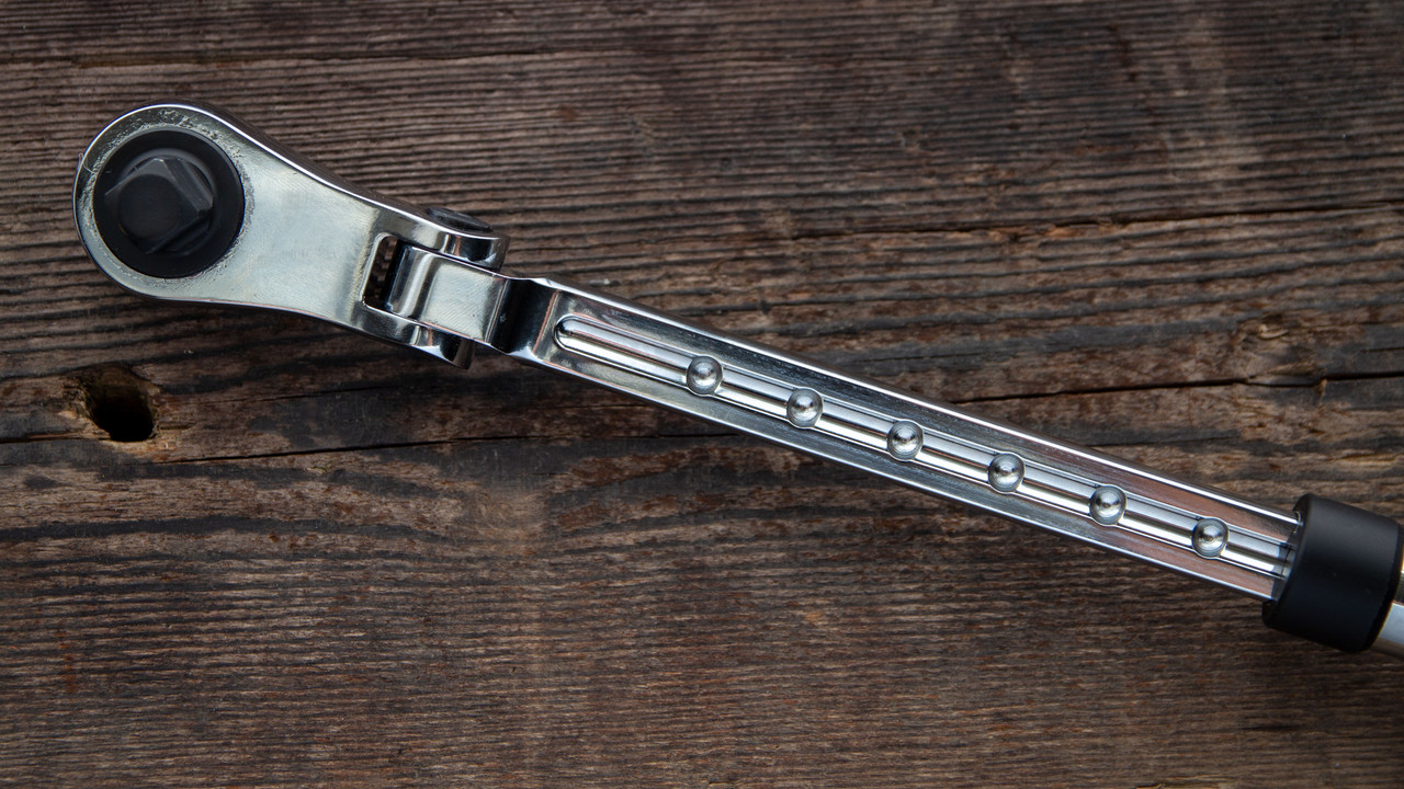

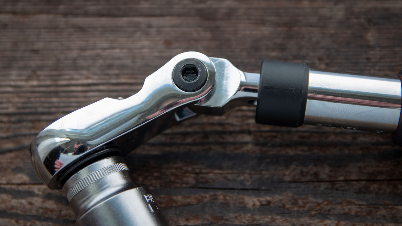

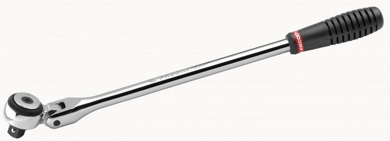

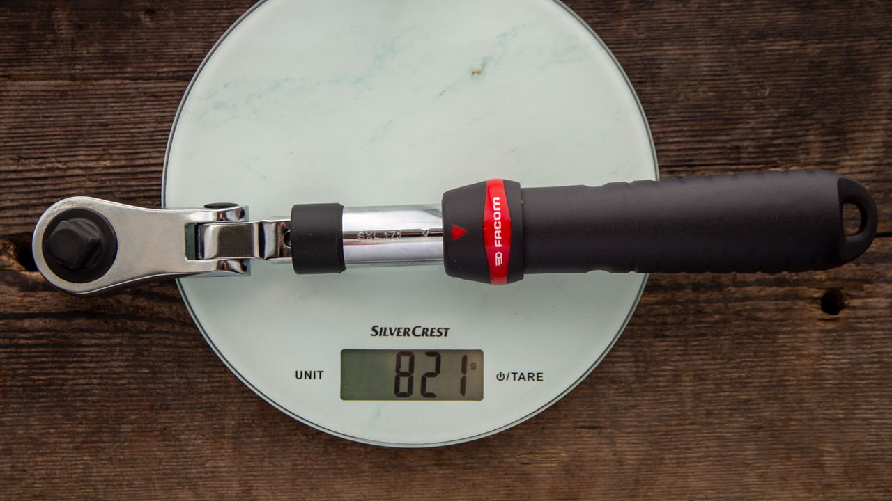

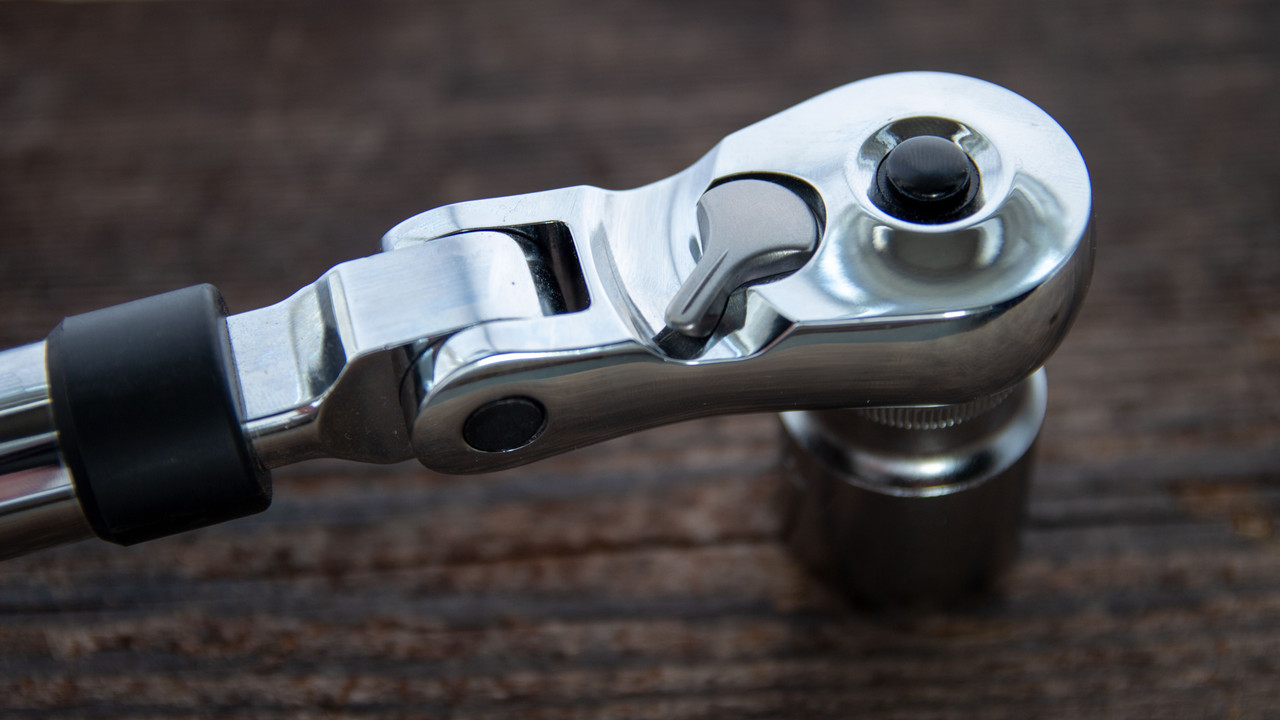

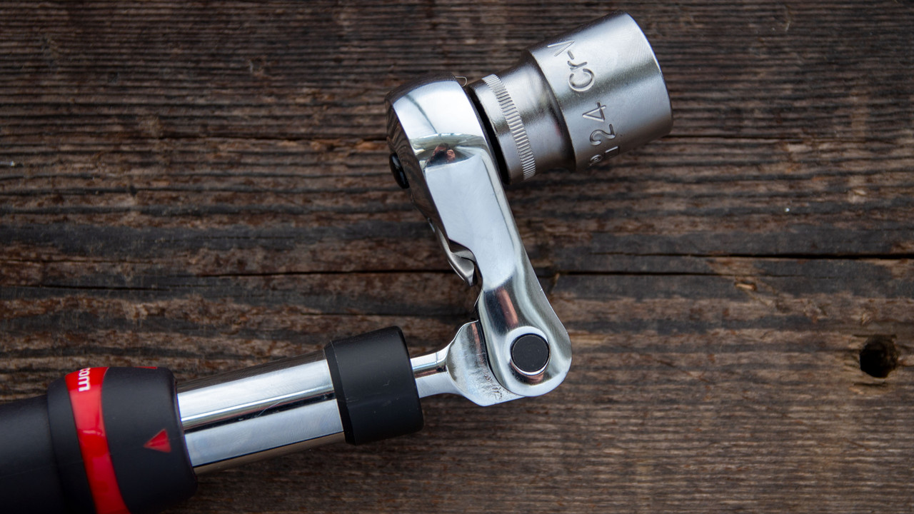

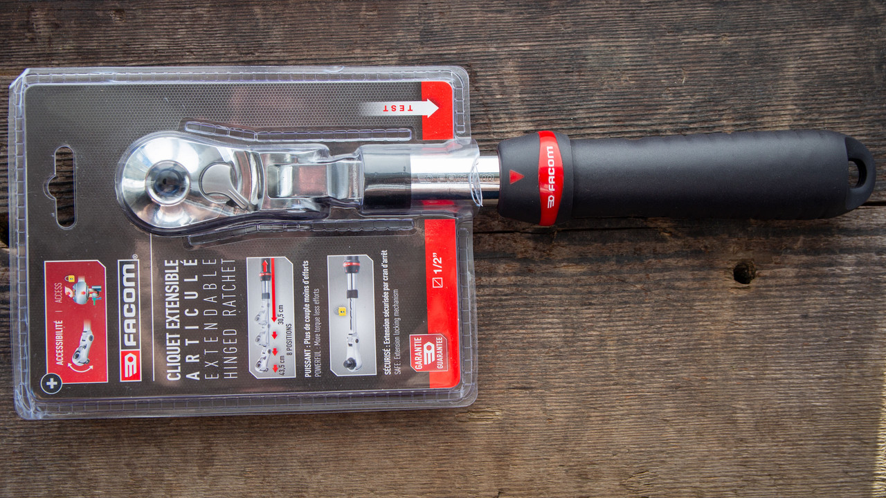

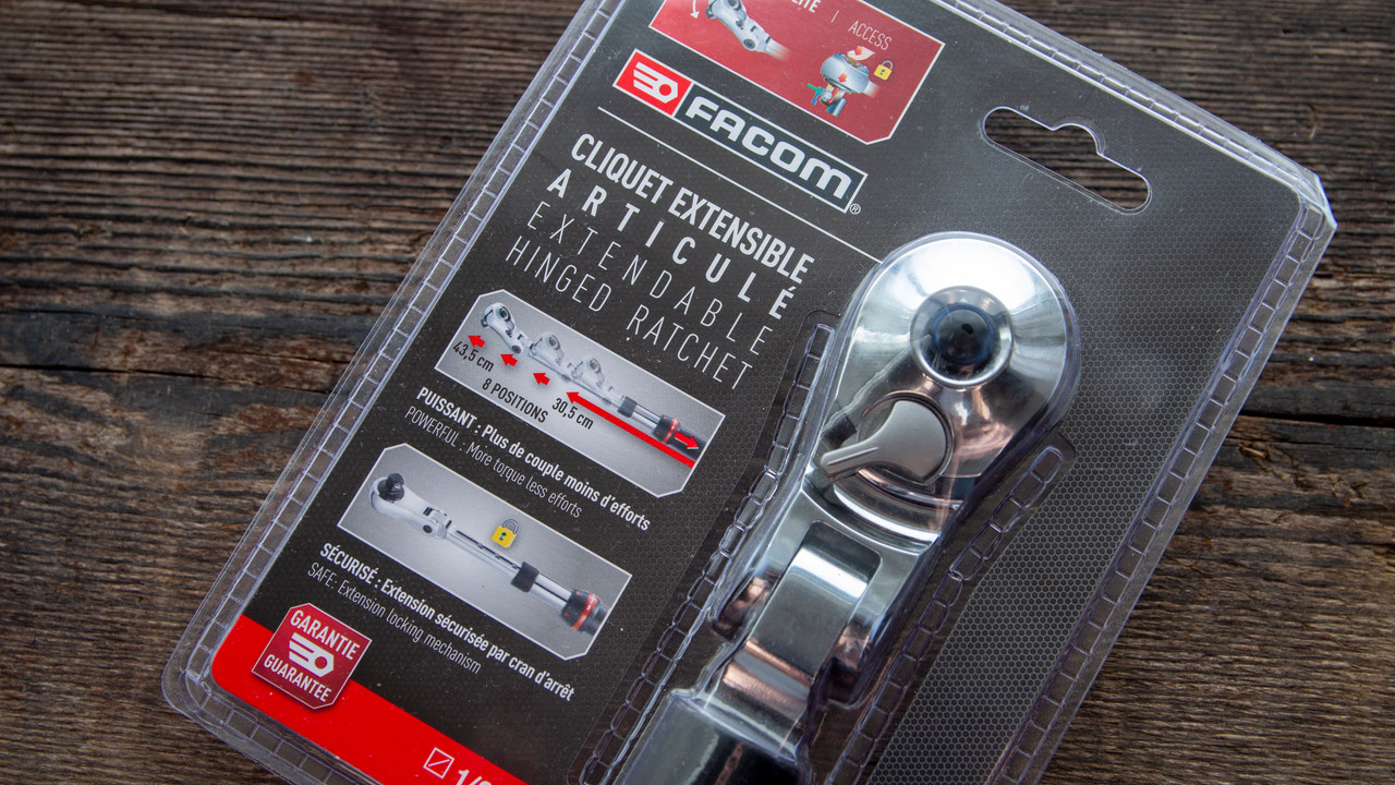

Facom SXL.171 1/2 extendable flex head ratchet.
Been curious and skeptical about this one for a while. Online reviews and first hand accounts were hard to find which could be because no one else has been daft enough to buy one. My tools need to be portable so I like the idea of one ratchet to replace two or three.
72 tooth. Sealed head with quick release and recessed direction lever.

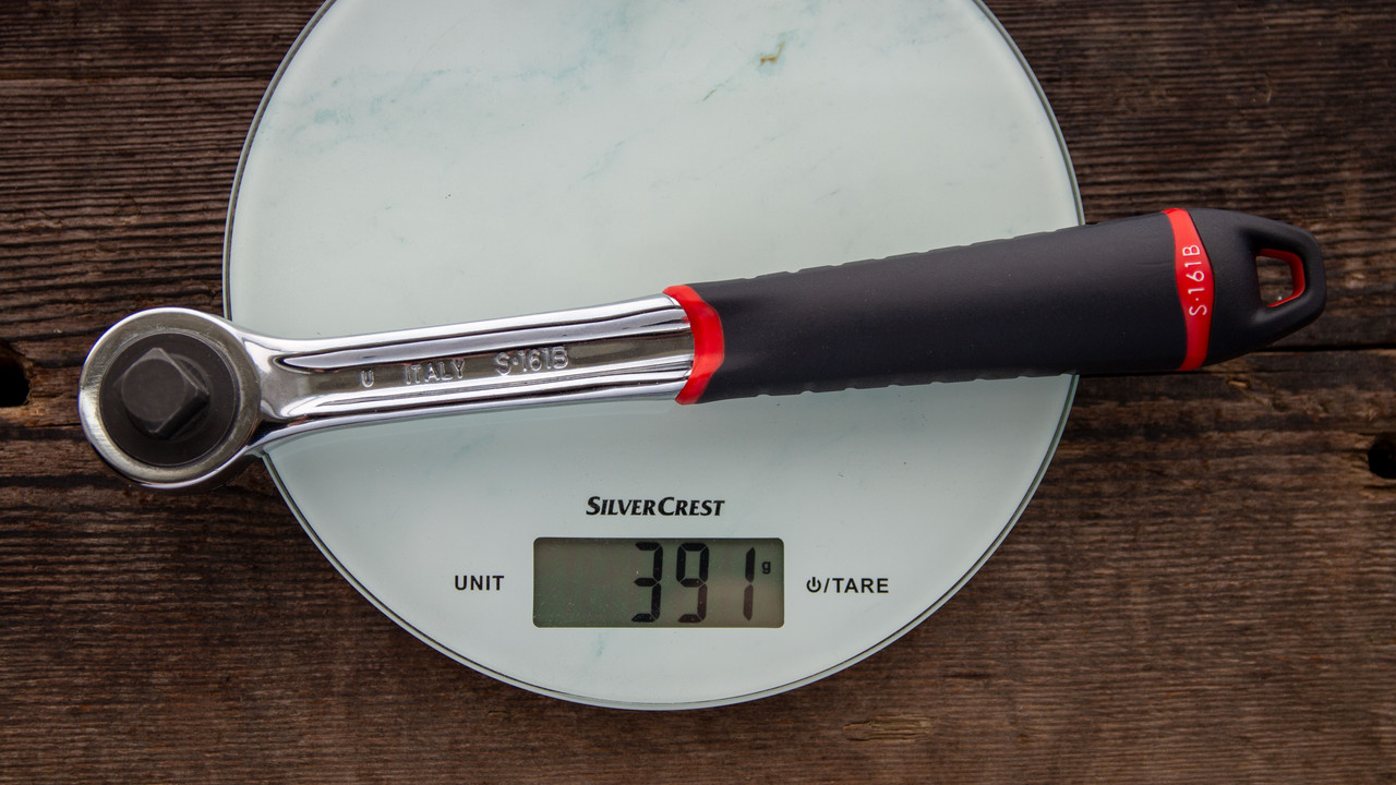

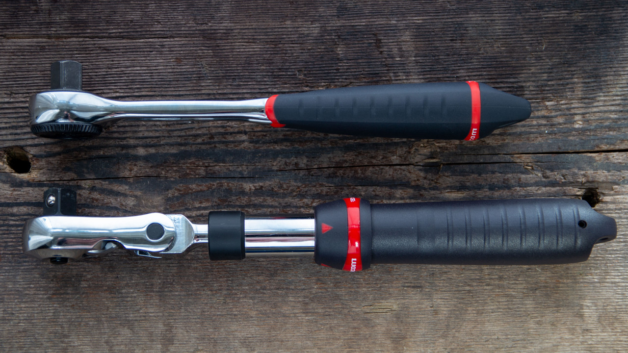

Compared to Facom S.161B standard 1/2 ratchet.
The SXL.171 feels much heavier and bulkier than the S.161B.
Just over twice as heavy.
From 305mm to 435mm.
Pull down on the sprung collar to extend.
Eight positions.
Flexes just past 90 degrees forwards and backwards.
Flex head can be tightened via T30 torx.
No COO on the ratchet or packaging. :(
Facom discontinued the S.153A which is a fairer weight comparison. (750g Length = 405mm)
