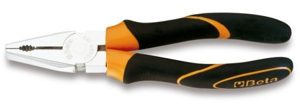

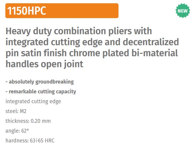

Unsure exactly what makes them 'Heavy Duty.'
I have the older style, and I still think Beta is one of the best producers of polished chrome finish on pliers.
If I had to guess, based on the differences I can see between the old style and new, I'd say it's probably the off center placement of the joint which gives higher leverage, and maybe the satin finish to reduce chipping. The 60-63 hrc hardness is pretty normal for pliers and cutters that I've seen, so I doubt the material is any different.
