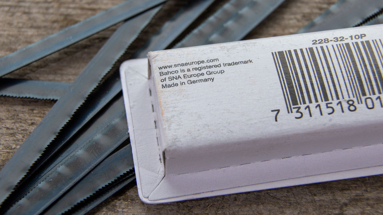

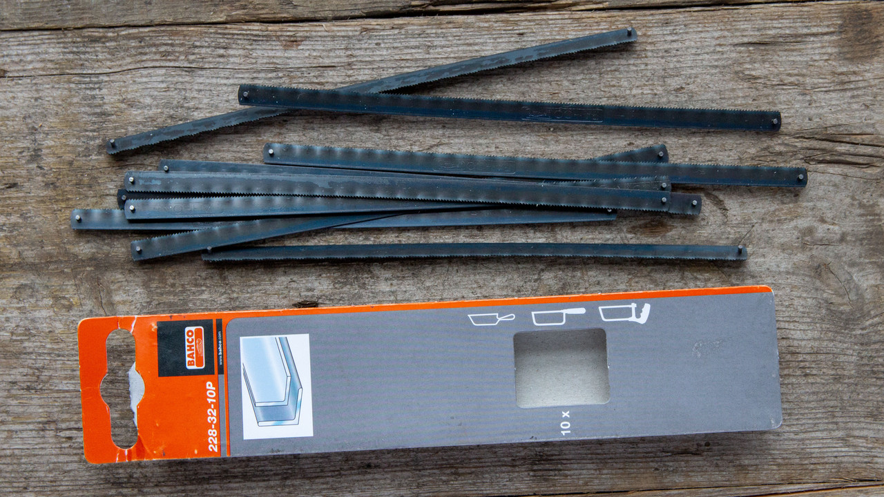

Bahco 228-32-10P 150mm hacksaw blades.
Box marked 'Made in Germany.'

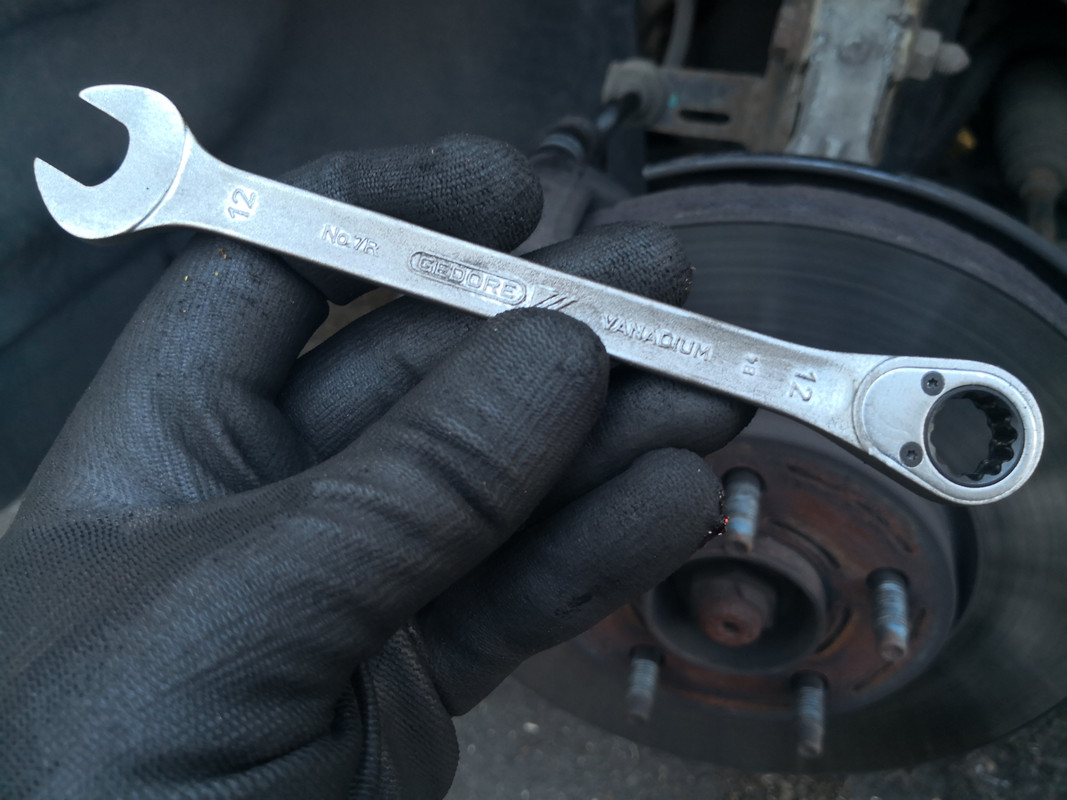

A few posts ago I made a bold claim that I may be able to bend a Gedore spanner in my hands. Today after using the spanner and not liking it so much I thought f'it and attempted to bend it. It easily flexes a small amount however could not come close to bending the beam enough for it to deform. Sorry Gedore for my previous slander. :bowdown:
I will say though they are a tool polishers nightmare. After just one use I cannot get it clean. Even after a good wipe down (dry rag) there is dirt in the finish and between the logo and lettering. Not had this issue with other satin finishes.

Yeah. As you probably know, steels all have similar stiffness even though their strengths vary enormously. Any good spanner uses a strong alloy, and because your Gedore has an approximate I-beam section, even less steel than usual is needed to achieve the necessary strength for applying torque to a fastener. With minimal metal and a shape that does nothing for stiffness in the wrong direction, it doesn’t surprise me that it feels flexible. But as you observed, it can flex elastically a long way without taking a set. That’s the strength of the steel showing.
What don’t you like much about this ratcheting spanner, by the way? Just the finish?
From own experience with the Gedore satin chrome finish on the tools. Parts cleaners and a rag is great for keeping the tools looking sharp.
Not as easy as shiny chrome finish.
The finish isn't a real issue, just something I noticed. Part of my job is working in a clean room (lab) environment so I'm a professional tool polisher. :bounce: I was using the Gedore alongside and comparing it to my Halfords (same or very similar to Gearwrench) ratchet spanners and prefer the Halfords. The ratchet mechanism in the Halfords is smoother with quite a bit less back drag. Pains me to say on this thread but I prefer the Chinese made spanners. :eek:

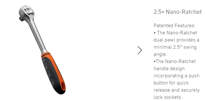

Interesting, the 2.5 degree ratchet head looks just like the old triangle tools ratchet recently brought back by Motivx tools only with a comfort grip handle:headscrat
Just googled them. Same specs and same name 'Nano-Ratchet.'

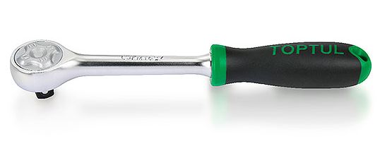

Interesting, looks like Toptool has all three sizes of the "nano ratchet" and Motivx brought back the 1/4" drive set (with minor revisions) of the Triangle Tools drives and sockets.
I bought two of the Triangle Tools 1/4" drive sets and it's my "go to" 1/4" set (gave the other set to a friend). I wish I'd bought the 3/8" and 1/2" sets when Sears was clearing them out. I was disappointed when Triangle Tools disappeared. Glad to see that the other sets might be available again.
It really seems like Toptul has a version of almost everything coming out of taiwan.

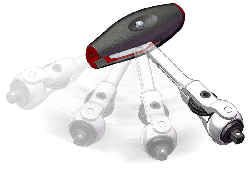

Similarly, they have the "rotating handle" ratchet, (I purchased from BGS for 17 Euro off amazon)
