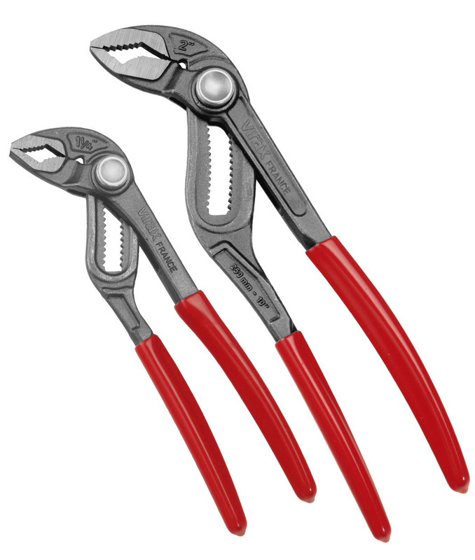

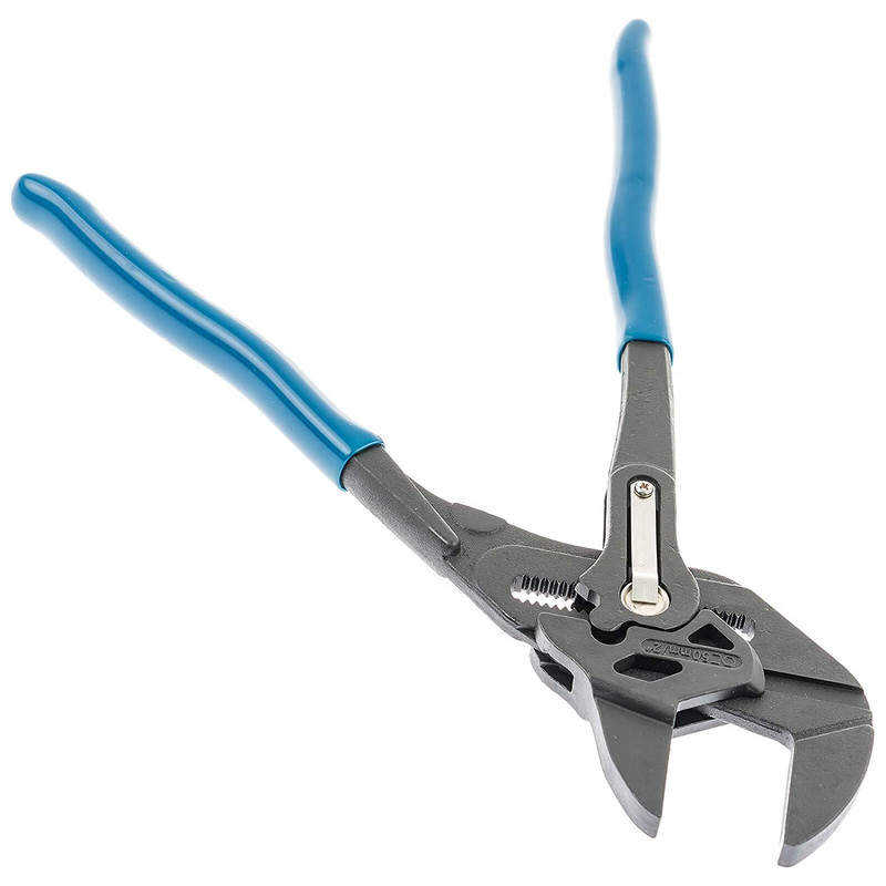

Latest ChrisCas video got me looking for pliers wrench alternatives. Spotted these from Virax. They don't look anything special, but I'm happy to see what may be lower cost alternatives becoming available.
<iframe width="560" height="315" src="https://www.youtube.com/embed/-ebyxfBrhMM" frameborder="0" allow="accelerometer; autoplay; encrypted-media; gyroscope; picture-in-picture" allowfullscreen></iframe>
The above pliers look Taiwan to me, but Virax pliers and screwdrivers look to be mostly Bost. Assuming these 'Cobras' are Bost.
I believe Virax may now be owned by Rothenberger.
( I presume Stanley sold them after acquiring Facom)
If so, the pliers might be manufactured in Spain, were Rothenberger owns Super-Ego. Super Ego in Spain seems to manufacture Rothenberger pipe wrenches, pliers, pipe cutters, and some other Rothenberger items.
Otherwise it might be Asian, although all the Rothenberger items I’ve gotten have been made in Europe or the USA, although in Europe, not always Germany.
I’ve seen complaints about “Asian” Rothenberger tools online, but I think they were mostly on a UK tool forum.
