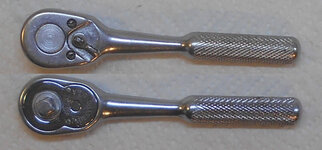

A couple of 1/4" Stahlwille ratchets. Great is that spare parts are available for nearly all ratchet models including the heads for torque wrenches. Some parts like the plastic handles are not in the catalogs.
For really compact handles you can remove the plastic part of the current coarse ratchets, what remains is a cylindrical shaft with a rounded end. its diameter is smaller the the corresponding steel handle. A Dremel can be used but one must be careful to not damage the chrome-plated shaft. Do not cut down to the metal, carefully pry open the handle using some wedge or screwdriver. The plastic part ends destroyed while being removed but is easy to replace (can be warmed up).
The 3 common Stahlwille ratchet systems are the old classic one, the old fine-toothed one with a knurnled disk and a metallic or black cover and central screw (TORX, a long time ago Allen (INBUS)) and the more recent very fine-toothed system wich a plastic (shame on Stahlwille!) cover plate, a fine-toothed rotating part and some moon-shaped locking part. They're also available in 3/8" and 1/2".
The 3/4" and 1" are of the older coarse-toothed type (rotating parts of the 3/4" 552 and 1" 882 are interchangeable).
The 2nd pic shows an custom-made 1/2" drive in a regular 3/8" ratchet body (simply replaced the 3/8" rotating part by a special 1/2" rotating part of a ratched head for torque wrenches). Spare parts for INHEX (Allen, INBUS) and TORX 1/2" sockets are also shown, damaged driving parts can be replaced.
The 3rd pic show different 1/4" bit tools. The Stahlwille 1/4" bit holders are among the few tools I do not recommend, the former versions featured a C-shaped wire clip and the current one a replaceable toroidal spring but it is not convenient, some bit forms are hard to remove.
Many Stahlwille bit adapters are 3rd party products anyway. The smallest bit-ratched is an reversible ratchet from Ironside, surprisingly good indeed.
Some additional pics for comparisons. A very compact bit-ratchet is extremely useful.

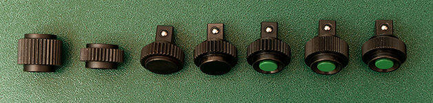

I'll reply in detail later. For now I add some pics. The smallest and the largest (Art. 735/80, 3/4" female, 1000 Nm, non-reversible, here disassembled) ratchet heads. The large one is mechanically specific, for the ratchet heads 735/80, 735/100 as well as the integrated heads of the 714R/80 and 714R/100, 730DR/80, 730DR/100, 721Nf/80, 721Nf/100 Manoskop torque wrenches though the forged body is different for the torque wrenches, the spare parts for the ratched itself are the same. The mushroom-shaped parts are a bit tricky to insert with the springs but easier than repairing a 1/4" 80-tooth ratchet with its tiny spare parts. :)
Basically, rotating parts are swappable if their diameter, height and teeth are identical, from there it does not matter if it's a standard or QR (but not 80-tooth fine QR, oftenn called QR N) and if the drive is outer or inner square, or for hexagonal bits). I'll try to post a compatibility list later as there are some subtelties, like fine-tooth with screws, G versions or heads with higher rotating parts than the corresponding ratchets.
BTW the rotating part of classic ratchets (can be inserted turned by 180° which make inadvertently hitting the lever less likely as the lever is now at the bottom. Also for any "classic" (i.e. 22-teeth 1/4" / 30-teeth 3/8" / 36-teeth 1/2", non-"G") ratchet, the QR and standard rotating part are interchangeable within a minute or so any time.
As some details are not that obvious, just ask in the forum and I'll try to reply. As said, I'm unrelated to Stahlwille or any tool vendor or representative.

@littlebean
(Not sure if I manage to quote your message, sorry.)
AFAIK There a following versions of the 60-teeth ratchet systems, only male square drives are available:
1/4" body size
3/8" body size
3/4" body size
3/4" HD (Heavy Duty 650 Nm) body sizes
The 3/4" sizes are only available as heads, not usual ratchet with handle.
1/4" body size:
Only 1/4" rotating part:
For 1/4" ratchet 411 (and similar no longer listed ones if applicable, e.g. same head but other handles).
I don't remember for sure but I believe there was a small ractchet head for torque wrenched but it is no longer listed since quite some time.
Only 1/4" male square drive.
3/8" body size:
3/8" rotating part and 1/2" rotating part.
For 3/8" ratchet 422 (and similar no longer listed ones if applicable, e.g. same head but other handles) and ratchet heads 735/5 (3/8") and 735/10 (1/2").
Therefore 3/8" to 1/2" and 1/2" to 3/8" conversions are possible but the maximum torque with 1/2" square drive is lower than for "full-fledged" 1/2" ratchets as the size of the parts is designed for 3/8" square drives.
Using a 1/2" rotating past in a 3/8" ratchet body can be convenient due to the smaller size but it is not a replacement for true 1/2" ratchets where high torques are required.
1/2" body size:
Only 1/2" rotating part.
For 1/2" ratchet 515 (and similar no longer listed ones if applicable, e.g. same head but other handles) and ratchet heads 735/10 and 735/20. The torque limit of the ratchet mechanism is 300 Nm (usually the male square shears off first, I can post a pic later).
3/4" body size, normal (non-HD, i.e. 400 Nm) version:
Only 3/4" rotating part.
For 3/4" ratchet head 735/40. The torque limit of the ratchet is 400 Nm.
3/4" body size, HD (Heavy Duty, i.e. 650 Nm) version:
For 3/4" ratchet head 735/40HD and 735/65. The torque limit of the ratchet is 650 Nm.
The 3/4" non-HD and HD are different, the HD is larger.
In some cases, knurled discs of two different diameters can be used for the same 60-teeth ratchet.
Very important: The central screw must be tightened very carefully, if too tight, the mechanism locks up. New original screws are provided with some thread-lock pre-applied, each time a screw is removed it must be replaced or thread lock newly applied. Original spare part kits include 3 screws to allow 2 maintenance disassembly.
As threads are metric, also 10.9 Allen (INBUS) countersunk screws can be used, ISO 14581 (formerly DIN 7991), make sure to use 1st quality screws as they can be hard to remove. The original 10.9 TORX often end damaged, I absolutely hate TORX with a passion!
Diameter and length depend on the ratchet size. The original screws are no 100 % standard but regular equivalents can be used.
The two first pics show the difference between 3/4" HD (650 Nm) and the smaller standard version (400 Nm).
The 3rd pic shows an old body, the teeths are usually fine, mostly the rotating part ends wears down, see pic 4. Also the locking segment can wear out or even break aparts. The heart-shaped spring rarely ends damaged.
