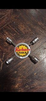

On another note, I got the Koken wobble fix 1/4 spinner screwdriver, to accompany the zeal 1/4 sockets and much to my surprise the fixed position doesn't work. the socket won't stay put. Big dissapointment. Has anyone else encountered this?

This is why there's never been any wobble-fix extensions in the Z-series.
Z-series items work best with its own brethren.

Koken 2763, 3763, and 4763 series are wobble fix in all 3 common sizes, but not Zeal series. They don't work well with any short sockets or hex or torx sockets even in the Zeal line.
Did you try the larger sizes of 1/4" sockets? On my koken wobble extensions they start working once you get past 9mm if I recall. But I don't have a spinner screwdriver, only the extensions.
No, the sockets I have are 3,4,5 mm hex and t25 torx and none works
correct, the hex and torx bits in 1/4" use a base size that's between the 8mm and 9mm, hence none of them work on the wobbles. If the base of the hex and torx were the size of the 10mm socket then they would work fine on wobbles. The Nepros versions fit fine. I sent an email to Ko-ken because the detents are also placed incorrectly leaving an absolute smidgen of detent ball engagement :( Sad they didn't think through their design enough! :(
