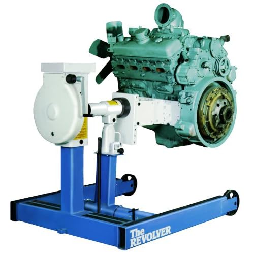

I agree with Outlaws idea, I built many engines and some stands are more difficult. Now with my disability I am not dead and would like to build more engines. I would like to rebuild 4BT and 6BT's for myself and others but can't turn blocks over anymore so need a Handicap Stand of sorts. Additional support via motor mounts for different engines, make the stand modular with attachments for tools, nuts/bolts, permatex ect. Maybe hydrolic/geared height of stand, tray with drain tube below to jug. Tires with air as I hated pushing my BBC 402 and them little wheels snag on a washer and jolt the BB. I also like the "I" style, should be able to make it foldable in this century. Maybe power strip option. I would like to test it with a 4bt and be able to adjust/assemble into running engine on it would be a plus.
metal4130
Feb 11, 2008
225
I third the OTC "The Revolver" stand. I have 2 of them and they will handle whatever you throw at them.
They roll around the shop nicely and it is very easy to rotate the engine once mounted. They are the best stands I have ever seen. Overkill for small gas engines but just right for larger Diesels.
