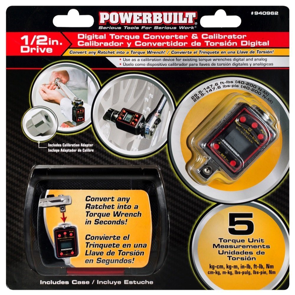

If torquing down lug nuts will be the only use, I'd recommend a digital adapter, like mine:
You can actually see exact the torque you put on.
If you like mechanical, Harbor Freight is pretty cheap and good. Tekton is nothing special and probably made in the same factory.

Do you need to keep a dwarf spotter around to watch that needle move just inches off the ground? :D
Ha! First time I put it on a lug, I thought "How the heck do I read this?". Then the light bulb came on and I thought to keep it as close to vertical as possible. Sometimes simple things aren't so simple for me.
