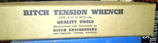

OFF SUBJECT, BUT INTERESTING
Years ago I bought an interesting torque wrench. It was made in Australia. I have not used it for fear of marking the original finish. When I bought this tool, it was wrapped in oil-paper and in the original cardboard box.
