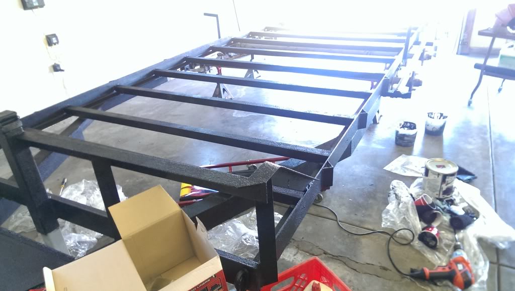

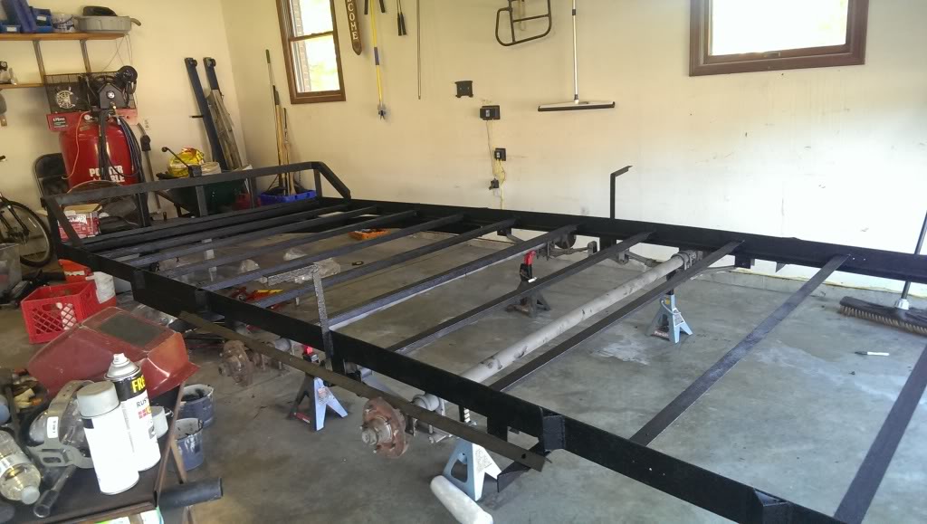

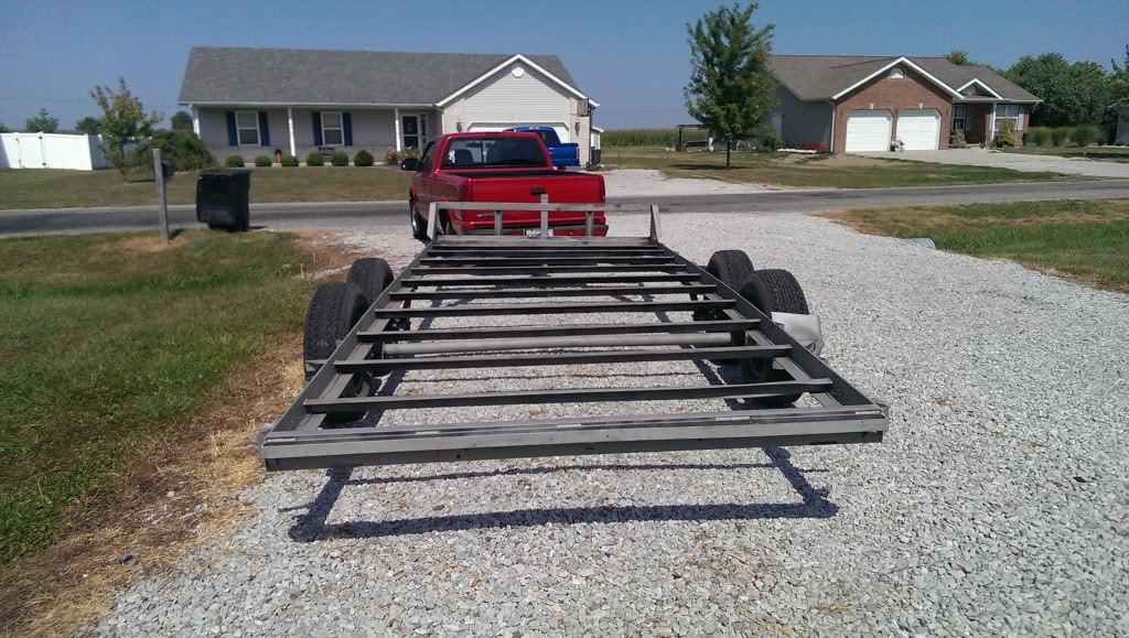

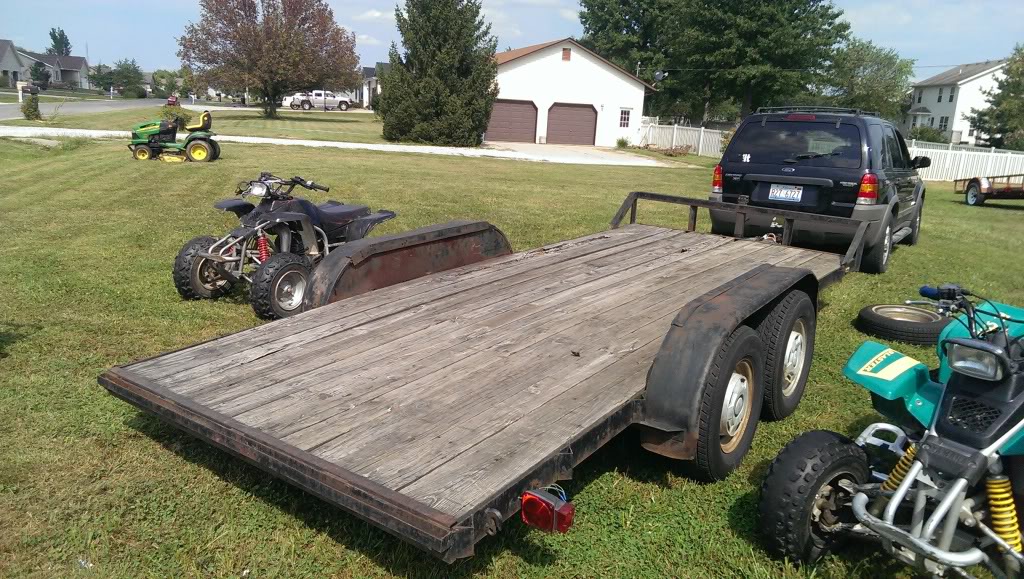

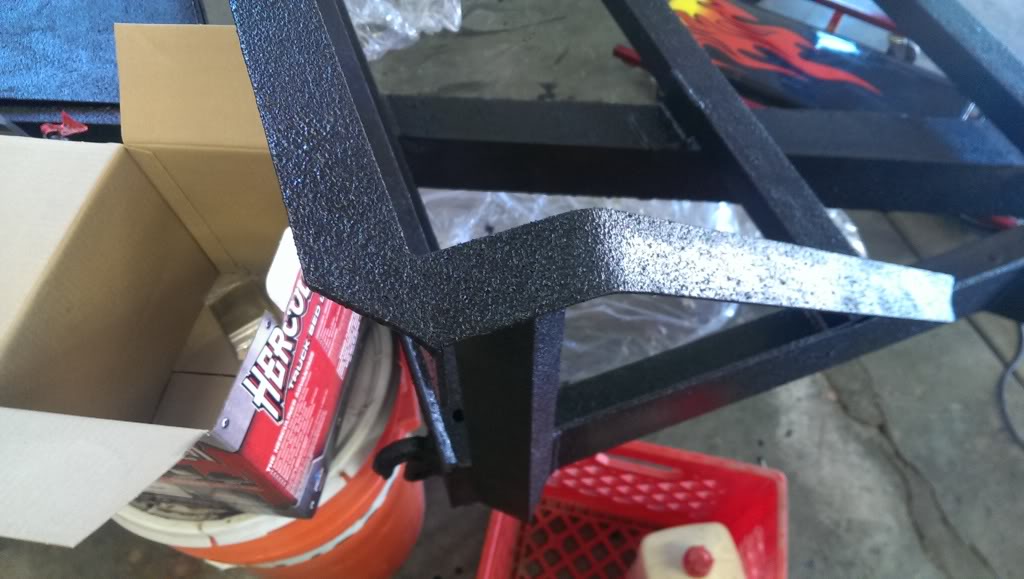

I decided I needed a project, so went on Craiglist and picked up a trailer. (also needed to remove an old camaro out of my garage)

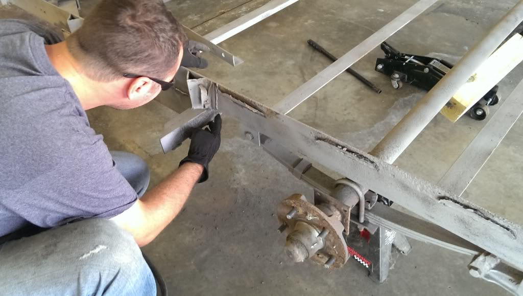

Upon getting the trailer home i started to go over everything that would need replacing, The wood was rotten out pretty bad, the fenders were rusted though in places. and the paint had seen much better days. The following day I took it over to our local powder coating shop and had them sand blast everything.
After getting down to bare metal a buddy and I started to clean up the old spots were the previous owner welded the fenders to the frame and proceeded to creating a mount for the new diamond plate fenders.

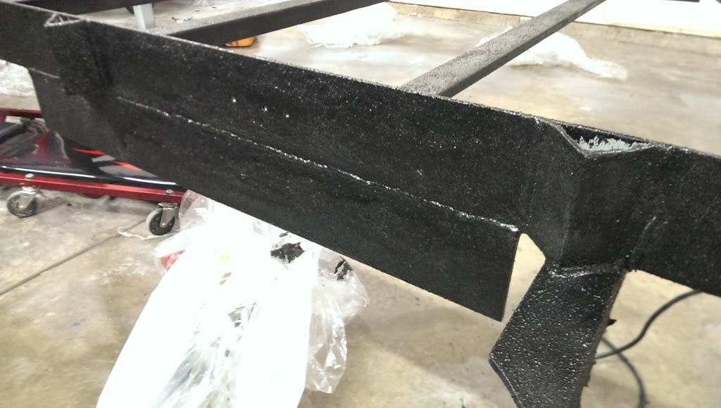

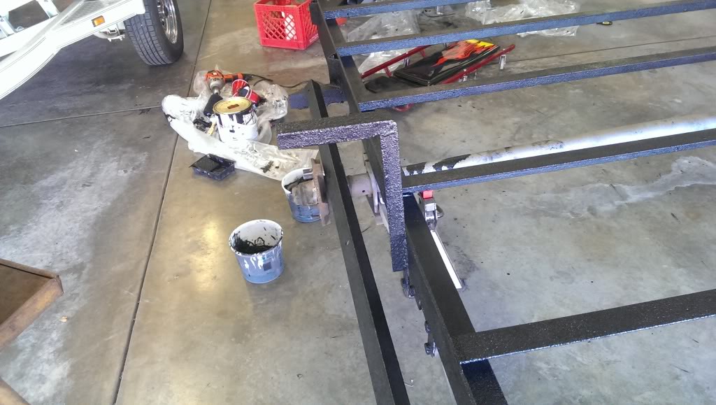

The over this nice labor day weekend we started to lay on the Herculiner over everything except for the leaf springs and axles. I am planing to cover those with rattle can black paint.

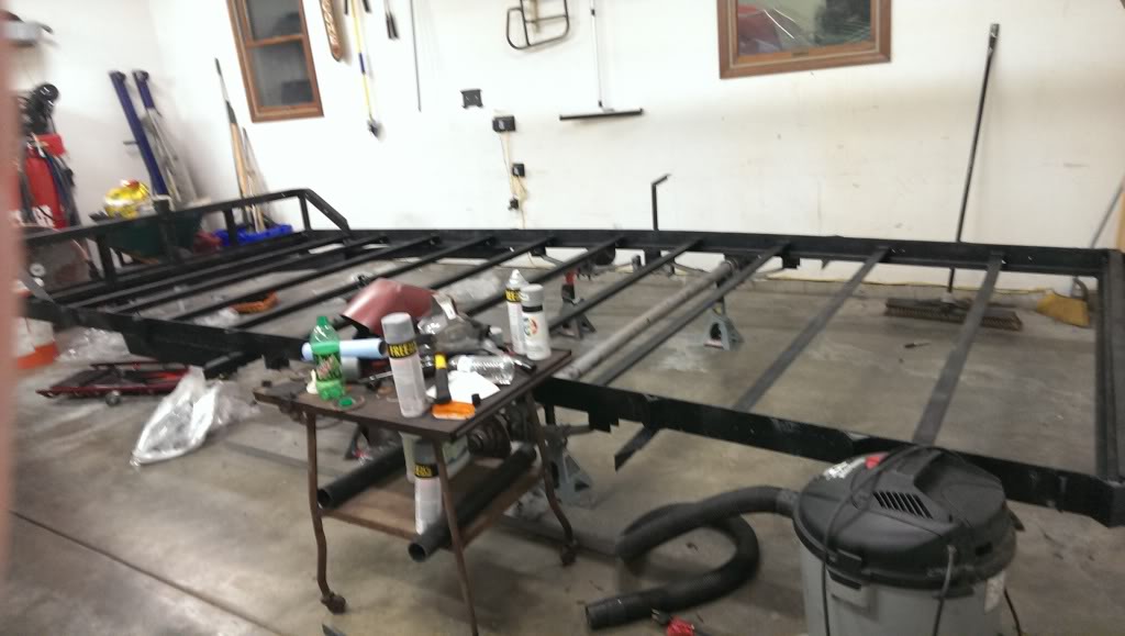

Still have a quite a bit of work to do. Still need to pick up wood for re-decking, finish painting axles, touch up some of the herculiner, and throw on a light set. Might even try to add a winch. Think a 3k winch would lift a car on this thing? Other then that what do you think?

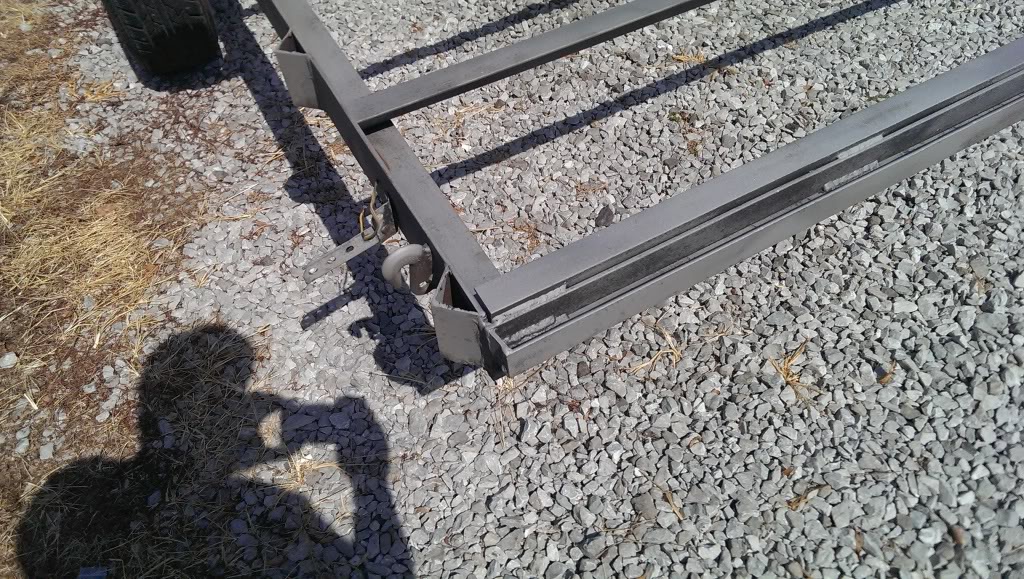

Kind of curious why you didn't straighten the frame before you put all this work into it. When we repair this type of trailer we line up the side rails and then put in a piece of tube steel above the axles to stiffen up the frame.
Did you mean strenghten, because I don't see anything that needs to be straightened? And then in the second sentence you talk about putting a piece of tube leading me to believe that you meant strenghten.
This could be my ignorance, however I was told the trailer was built that way? I thought it was kinda odd, but took the guy for his word.( it does have a slight curve to it) Also I figured anything I put on it should not stress it too bad. Do you have a pic of the thing you do to straighten them?

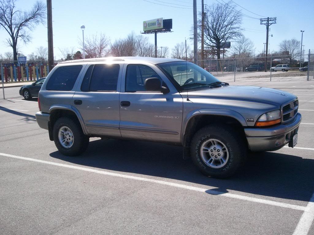

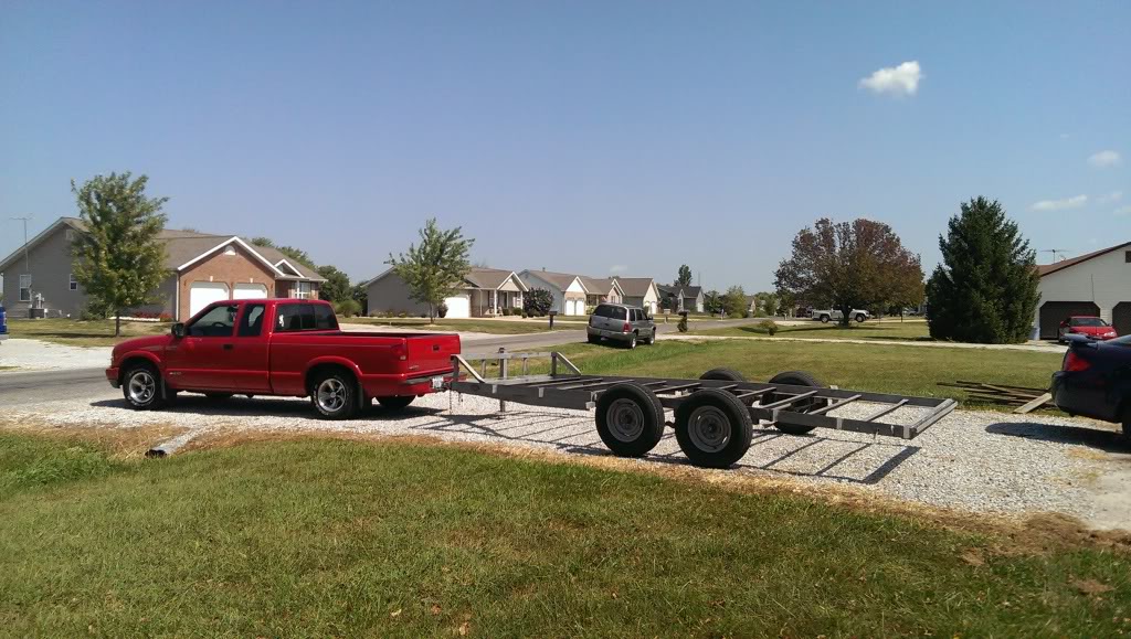

Is that your S10 pulling it? 4 or 6 cylinder? If a 4 cylinder how does it perform power and braking wise?
I have a 1999 dodge durango I saved from a junk yard with a 5.9 360. That is what I use to pull this guy and the boat. For just moving it the escape, and s10 work pretty well. The s10 has a 4.3 with 5speed, breaking without a load seems fine, and would not try with a load on that little truck. The durango didnt have any issues at all stopping
Here is a durango pic

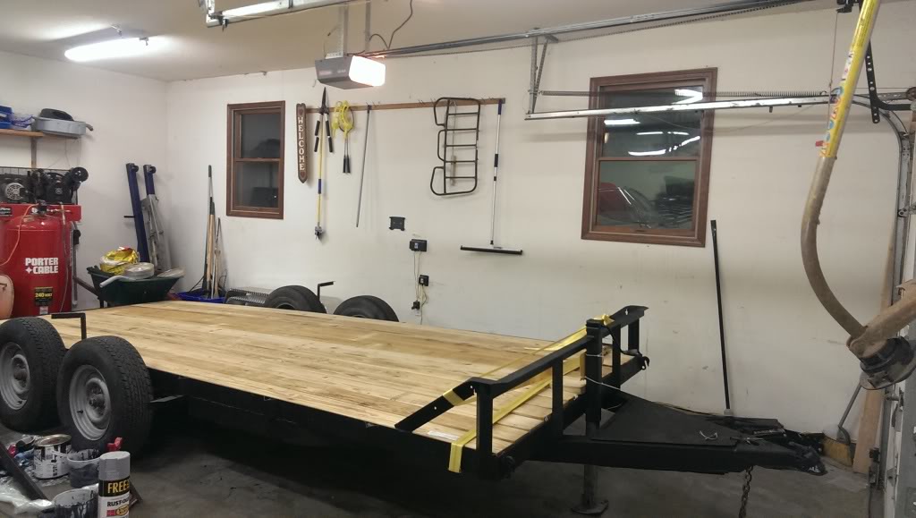

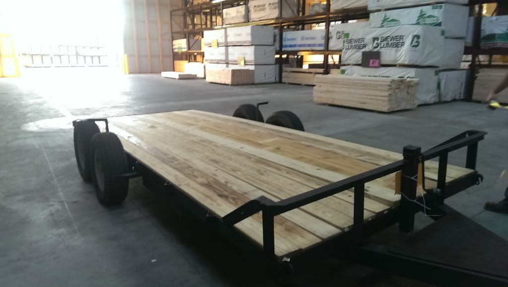

Picked up the lumber today , here are some quick pics. I was planning on using 13.5 2x6 however, 12 2x6 and one 2x8 fit perfectly.
At the lumberyard
In the garage

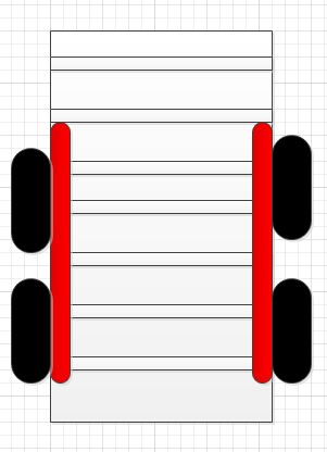

Don't have any pics of the repairs. We usually run a piece of tube about a foot past the spring mounts and keep it below the wood. That frame is already stressed and it will only get worse. It is still easy to do before you put the wood on it. It may take a few pie cuts to get it straight. Weld up the cuts, grind them smooth and install the tube.
This happens because of the lever action applied when the ramps are bearing on the back of the trailer while something is being loaded. Some blocks of wood or jackstands under the trailer will minimize the damage. The longer you make the tube repair the stiffer the frame will be.

Hi readhead. I wish to apologize for my earlier comment. Seeing the picture of the trailer, i wasn't sure if it was distortion or the angle in which it was taken. Seeing that Majerus acknowledged that there was a slight curvature, I realize there was no distortion in the pic. therefore I reiterate my apologee.

Check any local laws regarding brakes, in the UK any trailer with a loaded weight of over 750kg HAS by law to be a braked trailer.

That trailer needs brakes on at least one axle per Illinois law.
Is this what you are referring to. The Red would be the "tube"

How wide is your trailer, outside of tire to outside of tire ? How wide is your garage door ? How tight was the fit to get it inside ?
