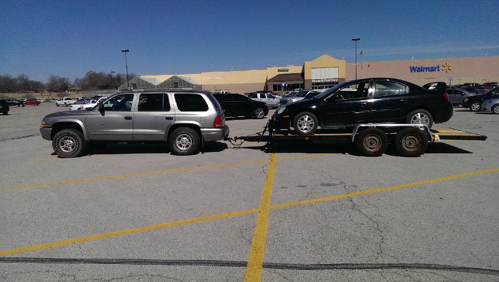

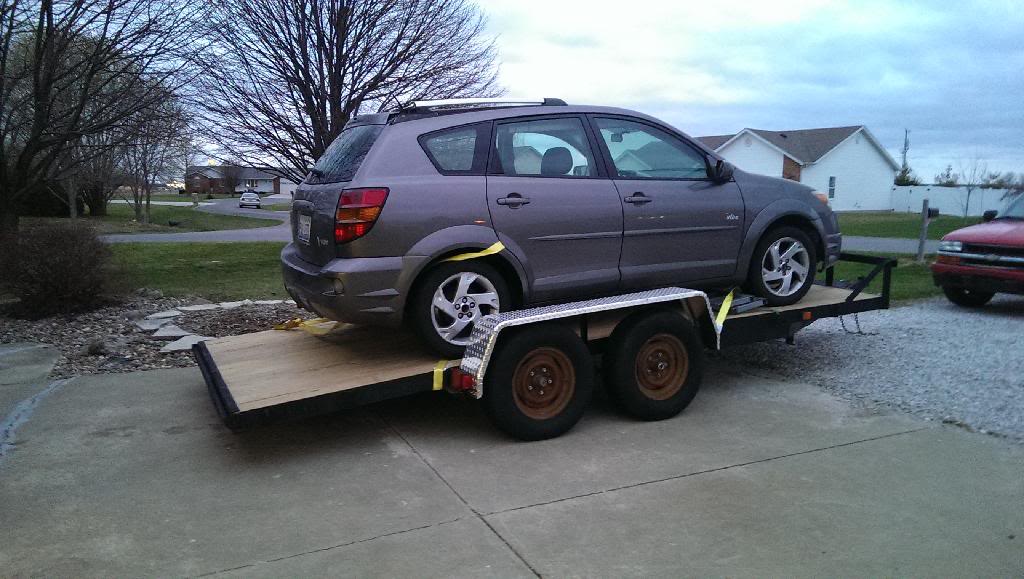

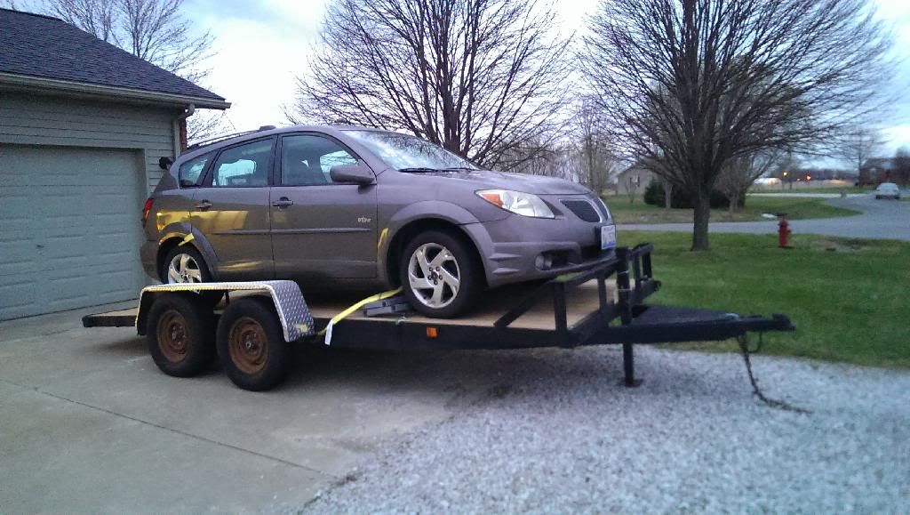

Its been a while since I have posted on this project, here is an update. I have the fenders on , wiring is ran. All of it is ran though the frame in wiring mesh to isolate it from abrasion. Side markers, tail lights all work really well. So far I have pulled two cars on it and it pulled really well. I have to get some rims for it yet other then that all buttoned up. I didn't get around to straightening the frame but at this point i figure it is easier to leave it as is.
Here is one with a car on it, this was the first time I towed with a two axle trailer. I was told the car should have been centered on the wheels which is why my durango is squatting so bad.
I pulled this car over for over two hours in the middle of a storm . Drove very straight no sway or anything.

Things to consider adding would be some side stake pockets to let you drop in some short buckboards to make it an open top cargo trailer for bulk materials.

I would strongly recommend having D rings welded to the front and back of the trailer - have a professional welder weld on a triangle piece of 1/4" or greater metal to the corners that ties both the front/side back/side rails together, then weld the D ring to that. They way you have the cars secured is very un-secure.
majerus
Feb 27, 2013
240
St. Louis Missouri
Good idea , those straps have a huge metal connecting point and its around the bottom lip of the trailer. I would think the straps wouldnt work with D rings, should I be using chains?

I use both.
I like chains in the front and 4" winch straps in the back. Most of the straps have a hook on the end for latching onto the "D" rings.
You should be using axle straps, wich are just short web straps with hooks on both ends, to connect the straps too.
You should not be tieng down the body of the car, either. Tie down axles and let the springs and shocks of the car "float" the body. You will have a much better ride and you don't have to worry about the straps and chains loosening as the body of the car compresses the suspension going over bumps and dips.
I guess the pictures did not show this very well, but what we did was went around the back axle and the just threw the extra strap (loose stuff in the door) ill get to adding the D rings and buying some actual short straps.
JHunter
Jan 27, 2006
76
DeRidder, LA
I'd recommend straps like this:
http://www.macscustomtiedowns.com/product/110/TieDowns
And D rings like this:
http://www.tractorsupply.com/en/store/erickson-weld-on-forged-flip-anchor-ring-15000-lb-maximum
The straps with the spring closure will help make sure that as the straps loosen in the first part of the trip (which will happen), they won't have a chance of coming off the anchor point. Good practice is to drive 30 minutes or so, then pull over and check your straps. Using a strap like that (and axle straps like someone else mentioned) will secure your load. The "cheaper" straps with the open mouth are usually not rated real well, and then there's the issue of the open design of the hook. I don't remember the math, but think about a 3k pound car on the trailer and the force of the load on the straps if you get into an accident - you want a strap that is rated well past the weight of the vehicle, and never rely on two straps. Wrapping the strap around the rear axle (even with an axle strap) and hooking the ends of the strap to either side isn't safe because if that one strap breaks, your car is no longer secured. I always go with 4 straps, and X them in the front or rear so you are snugging the car down to the trailer while also stabilizing it side to side.
Hope that helps - I just get a little nervous seeing cars on trailers on the highway so it's something I pay attention to.
