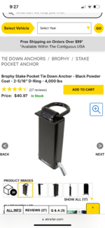

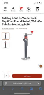

Bought a new trailer and looking for ideas to always have a foot jack incase I have a flat tire without added toolbox.
Wanting to fab a stake pocket tie down anchor and weld on a swivel jack adapter to the tie down anchor. This way I can have a swivel/removable jack to slide in any stake pocket and use as a floor jack incase I ever have flat tire. Easy storage too since it stays in a stake pocket and no need to get a toolbox to carry floor jack. Anyone ever fab such a thing for their trailer? If so, post your setup.

I guess I don't get how making sure you have the jack and adapter is better then making sure you have a 4x4 with you.
I would just make sure the pocket, adapter and jack are rated for the loaded trailer. A 2,000lb tongue jack is massively underrated for this application IMHO.

Going back to the OP's stake pocket concept, one could make something that would slide into the stake pocket like the tie down adapter except come up from underneath with some ears to stop it from sliding all the way through. Could even have a pin to keep it from falling back out, think upside down tie down adapter. Weld the jack adapter socket on the part hanging below the stake pocket. Excuse my very crude drawing, hopefully it gets the concept across.

If I were to make a stake pocket jack mount I would probably do something out of steel tube, sized to fit in stake pocket. Length would be determined by height of jack. . . . all in theory. . . I don't have the trailer to measure it all out.
Drill 2 sets of holes parallel with enough distance the stake pocket could fit between. This allows it to be pinned in place. . . up or down with pins like this .
Weld the swivel jack on one side of the tube, where the jack can be pinned for travel, up out of the way. Pull ********, pull pins and flip the tube over, insert from the bottom of the stake pocket, re-pin tube in place and remount jack to tube.
Basically creates a 2 position jack mount, stow position and jacking position.

Ideally the “ear” would be on the inside edge and meet the trailer frame. Then you’re lifting on the frame, not the stake pocket.
True, but that would depend on how your trailer was built and may differ on which stack pocket you happen to be using at the time. One could weld a piece of angle iron across the back side to catch the bottom of the frame, depending on your trailer that may require lengthening the device considerably.
