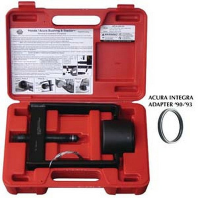

I don't like doing trailing arm bushings, due to tooling and the condition of the vehicles. However it seems to becoming more common
Normally I cannot fully remove the arm from the vehicle. It simply is not practical due to the condition of the vehicle, I'd be replacing every single control arm attached to the arm. So I will typically be working with the arm drooped down from the suspension, either suspended on bungee/straps or hanging from a shock/control arm. For removal, 498 air hammer, easy. On the older hondas with the deeply tapered arm I would just beat them back in with the 498 hammer. The outer shell of the bushings were thick enough to survive this, and removing anything else was typically not an option. Didn't look that pretty, but I gave a pretty big discount to use the technique and people got their bushings changed.
With the bushing above I cobbled together my C-frame socket press, ball joint adapters, and adapters from my bushing press kit. Very messy, very wobbly, took 4 hands which weren't always available, and needed 4+ attempts per bushing to get things straight. A ball joint press didn't have the throat required to fit around the arm to get things started. I have a normal Astro/otc sized one, and the Astro Goliath which is taller but with no additional throat. A normal sized ball joint press with more throat would not have worked, I need both the throat depth and the total height to be larger to deal with these bushings.
Is there a better method or more universal tool? I try not to blow people out of the water replacing these things, but to make things easy by fully removing the arm you're risking brake lines, hoses, control arms, other bushings, frozen hardware, subframe damage, etc. Things get pretty risky unless I go through and just blow everything apart with the torch. Which is nice, but $$$, so not my preferred method.
Mostly hondas, fords, subaru - would be my guess of primary usage. I'd hate to buy individual tools, probably wouldnt be cost effective.

I realize this is for Ford and Volvo but maybe it might work for other makes of trailing arm bushings. You might be able to fabricate something similiar
I did consider buying some plates of steel and fabricating something similar.

Am I crazy to think a big *** posi-lock or 2 jaw puller could accomplish install? Removal will always be an air hammer or torch job.

I think the Matco ball joint press has too narrow of a throat. I did confirm the CalVan socket press I used has a 2.5ton capacity, so I think I have a lot of options.

I recently replaced the trailing arm bushings in a 1995 Acura Integra. Used a tool that I bought on Amazon (https://www.amazon.com/gp/product/B0C4L6PT78/?tag=atomicindus08-20).
Short story: stay away.
To work, these tools have to be positioned just right and it is very difficult to position, even with two people working on it.
Perhaps it is easier if you have the car up on a lift; we were working on jack stands.
Maybe a model-specific tool that is well-built would work better.

For the subaru's there is a snap on kit that is not to terribly expensive and the press sleeves are better made and easier to lineup/hold while using than the universal chinese kits.
BJP1-BKS and BJP1-BKS2 covers the horizontal and vertical bushings on most of the Subarus (except the BRZ?)
