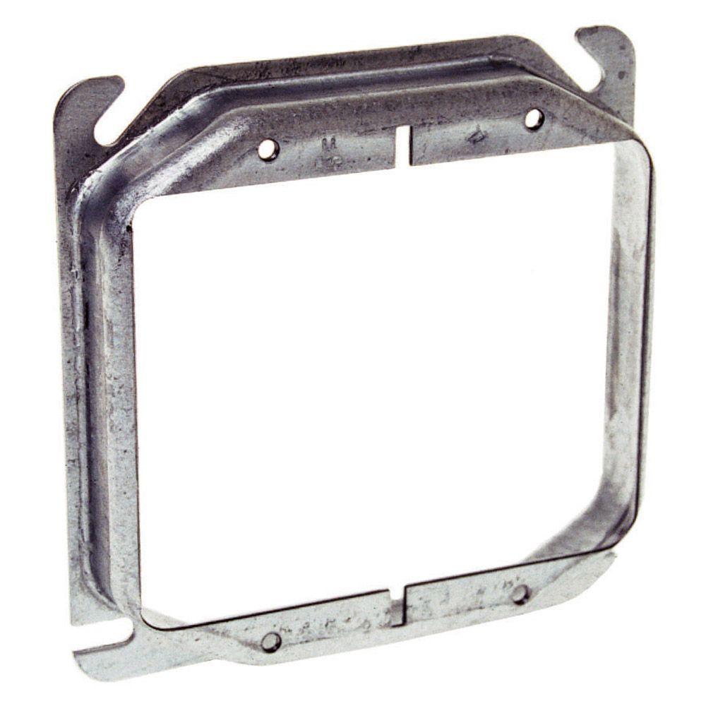

I’m running a circuit from a standard 1900 box behind drywall and then across an area of exposed brick and then back to 1900 box behind drywall.
I’m going to use 1/2” EMT on the exposed brick wall.
How do you make that transition? Can I buy a drywall faceplate that has both an outlet cutout and a 1/2” knockout for EMT?
Or is there a better way to make that transition.
