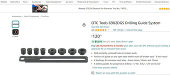

I see in thread above a drilling guide....
Does anyone know of a kit that would have longer bits and a sleeve for my situation? It may not be 3" but it seems like > 2" ( Preemptively: that's what she said).
Im in a similar pickle on a snapped F250 manifold bolt as i was completing reinstall. In my case the "blind hole" the bold slides through before getting to the head is a bit down and i don't feel motivated to remove the manifold and do the job correctly...
