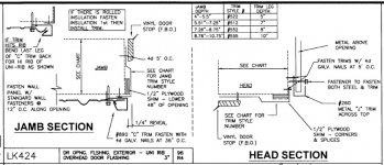

Here is how the flashing is done on my Lester building. The Head Section detail is the overhead trim, the Jamb Section detail is the sides.
Notice how the trim hangs down in front so water can't run back into the building.

Thank you lakeroadster! I was having a hard time picturing that in my head. Now I know what to look for when he tells me what he's going to do about it.

The door surround piece is one piece at the top, and one piece for each side (no seams).
The J trim goes outside, over the top of the surround trim, and the J trim is one piece and is open on each end.
No fix needed.. it works.
Folks tend to use J-trim in areas it was never intended to be used. On my barn the only place it is used, IIRC, is above the overhead doors, and the man door. None are spliced.
