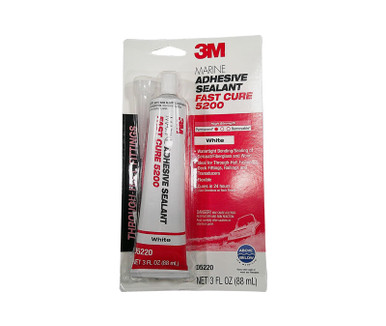

3M 5200 will surely work on the fiberglass but I am not sure about the countertop laminate. This is a crazy price I think but it's the first one that popped up.
5200 is widely used in the boating world. Generally it is thought that, if you want to separate two things bonded w/ it, you will need to destroy one or the other.
Thanks. I will see if i can find and i can experiment on a laminate scrap.

I think 5200 would work, or at least seal the joint. Contact adhesive may work to laminate the two parts. I'd scuff up the fiberglass pretty good though. My only concern about that would be water working its way between the two surfaces and causing a mold problem.
ETA Sorry forgot that you tried contact adhesive already.
