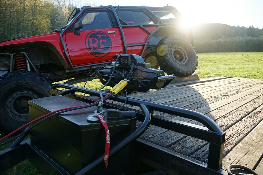

I have been busy in the shop, but finally found time to shoot a couple of videos recently. Here is the most recent video, outfitting a 10K flatbed into a purpose-built auto carrier. The video is hosted on my Youtube channel. I don't monetize the channel, so the only ads shown are putting money in YouTube's pockets, not mine. Subscribe/like/comment if you want to help the channel :beer:

Nice work, beautiful.
If you'd like some critique, I wouldn't have made the quick attach protrude onto the useful deck area. Next time you're hauling something square, you won't be able to put it tight to that front bar.

Yes, VERY good point. I mostly move vehicles/equipment, and when I move square(ish) things that are wide or centered I am aware I will be putting blocks on either side of the mount to use the front rail. In order to keep the winch relatively low, keep my existing tongue box, and keep the project complexity down, I accepted the drawbacks of the intrusion into my precious cargo area. Putting the whole thing about a foot higher and 8 inches forward would solve the issue.
