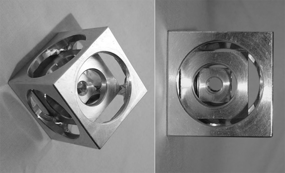

I admit it... I had never heard of Turner's Cube. I guess in today's world of CNC machining, the idea of one is obsolete, but that doesn't make it any less cool...

I have a couple of them I made last year. They're setting in the house on a couple of shelves. Everyone that sees them wonder what they are and thing they're cool. I have a formula wrote down somewhere that I can post up. The reason they're called Turner Cubes is that they were something to be made in an apprenticeship programs for Toolmakers. Most are made in a lathe with a 4 jaw chuck. Today, with CNC equipment you can make them fairly quick in a mill or lathe. There are different variations if you do a Google search for "Turners Cube" images. Some are made from cubes of Clear Lexan or other polycarbonate. Some guys have made them where they use a dovetail cutter to undercut the bores and the final bore will drop out a square that is loose but won't come out. Others have made them on a CNC mill where it would leave a round ball in the middle that wouldn't come out. If anyone (machinist) have signed up to the CNC Cookbook, it has a calculator that you can put figures in to make any size Turners Cube with 4 squares in it.
And yes, they are pretty darned cool!!!
Oh,...Ryan, the idea isn't obsolete. Today it seems like there are more and more making them and gaining back in popularity. They're used more in decoration now than as a lathe training project.

I don't know whether it was intentional or not, but the one Ryan posted is somewhat off center.
Here is one of two that I made a while back.
I think that's just gravity. The cubes are supposed to be free to rattle around.
In the touristy areas of China you can find similar pieces that are often hand-carved out of jade (or fake jade), often more spherical shaped.
I see that now. I went to the page Ryan showed and there was a larger picture. What threw me was Ryan's pic is sideways, but it all makes sense now and I'll be alright.:tard:
I didn't undercut mine to make them loose. The next ones I may do that.
