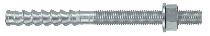

If I had extra depth, I'd take advantage and use 8" long all thread with epoxy. Now you're using the whole thickness instead of the mechanical anchors in the top half of the slap. I feel like that would make up for lack of rebar.
Had to actually look these up as I didn't full understand the process. This doesn't sound like a bad idea at all. Need to look more into them and make sure also the installed is familiar with them.

If you go the epoxy route, which I recommend, take a look at the Hilti HY200 adhesive system with their HIT-Z anchors. This is the system they recommended to me for my 2 post lift. This system does not require hole cleanup though I still did that. My pad is 5" 3500psi, with a 4'x12', 12" deep tray centered on the lift posts. I used the 3/4" HIT-Z, 9 3/4" long.
Did you install these initially or switch over to them from previously installed wedge anchors? I have wedge anchors right now and was thinking of replacing them with these since some of my existing anchors keep taking torque during monthly re-torques.
Wow these look great. Will look into these.

The HILTI brand Epoxy Anchors are super simple to use....
Have put in hundreds of them over the years.
Simply wrap a piece of tape around the bit (the depth stop always seems to be in the way or ......comes loose in mid hole) drill, blow out the dust...epoxy & anchor. .... used to be a 24hr cure time?
And of course it is easier with a HILTI gun & bit....no re bar makes the drilling easier.
