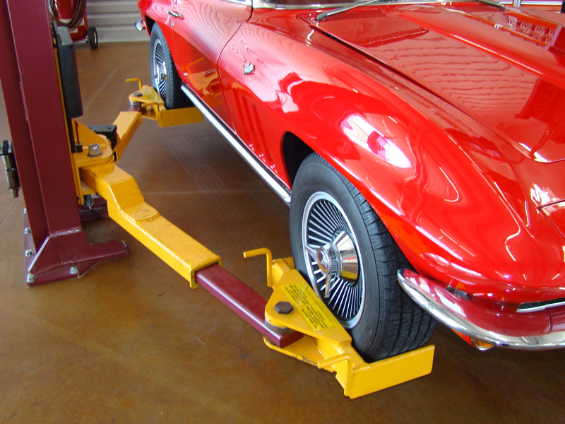

I have seen adapters to lift by the tires on 2 post lifts. maybe that would suit your needs better.

You would have to go with a platform lift, like this:
shopping
Mechanically, speaking, the anchors for the traditional two post lift are the bigger problem - not the car on top or it's suspension.
The anchors are not 100% reliable, which is why all 2 post lift companies will instruct to use auxiliary jack stands under them when operating. (Obviously, these can't be in place with another vehicle underneath.) When the anchors in the 2 posts have prolonged loads, (like if you were storing something at height) you are going to have a greater chance that they will pull out and have the lift tip over. (Epoxy anchors are susceptible to the creep phenomena and mechanical anchors can move - this is why we also have to regularly check the torque on them.)
