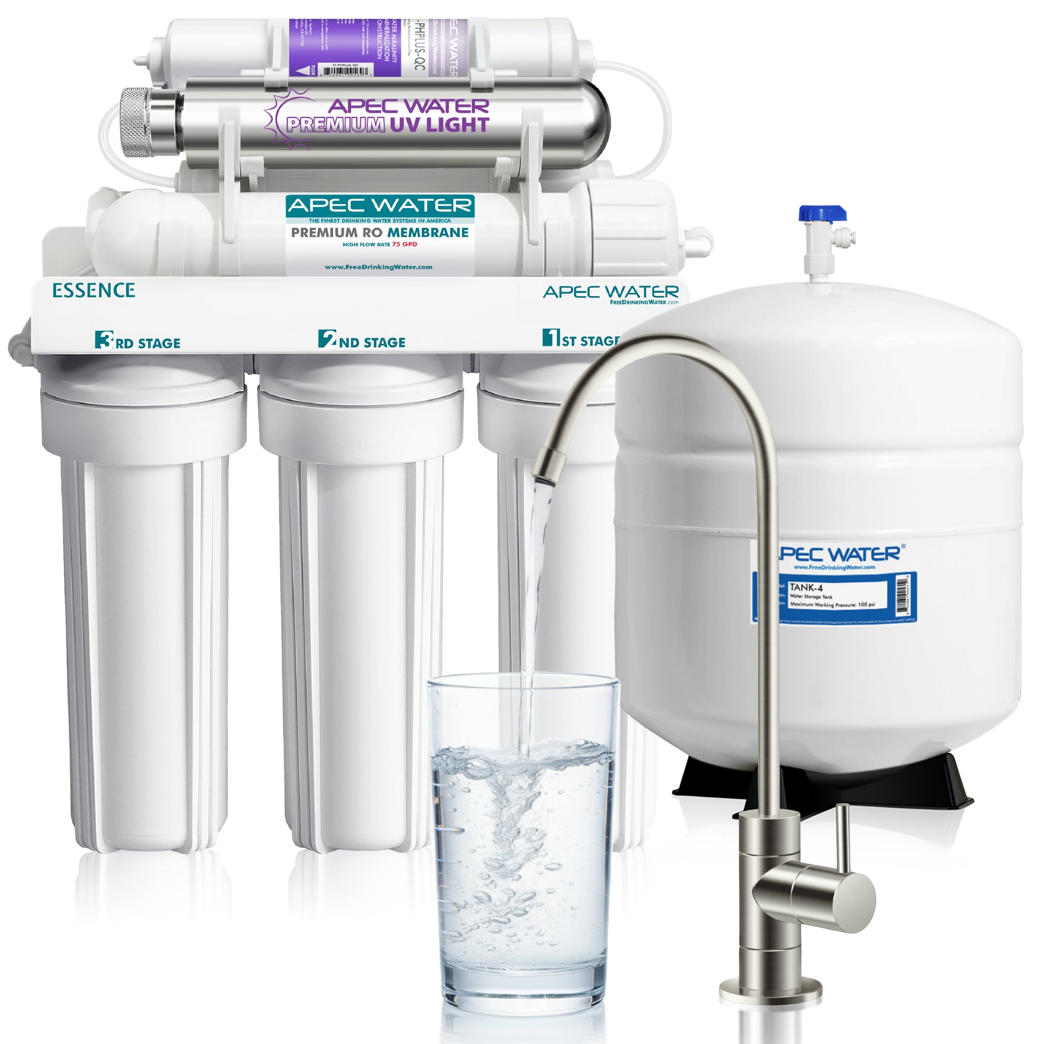

I have a curious electric outlet issue that I just discovered.
Our home in Louisiana, purchased last year, has a pretty elaborate 7-stage under sink water filtration system with a UV lamp. The water down here is awful, so I like having this for drinking water, etc.
I purchased a new set of the three filters and a UV lamp.
When I put the UV light in, it didn't come on.
The light goes to a duplex outlet under the sink, which is where the garbage disposal also gets power.
The outlet is switched. So, the UV light never worked, unless the garbage disposal was on (and likely the bulb was near new)
My issue is they didn't run power to the outlet, and then to a wall switch. But rather power the wall switch, than to the outlet.
I don't think there is an easy solution. Pulling a new wire under there would be pretty challenging.
Are there any other options?
