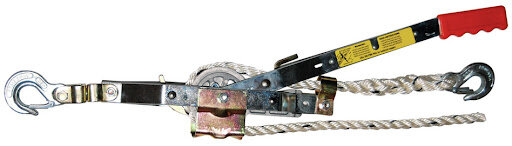

I am looking for a small, 1/2 ton or less, BIDIRECTIONAL rope puller. Basically a chain hoist for rope, with a lever. Or a come-a-long that does NOT spool up the taken up rope.

I have a Massdam rope puller. Don't know how to post pictures, but you can google search it. It does not wind up the rope. I think mine is 3/4 t though. Don't know if they make smaller

A tirfor does exactly that. It can climb along a cable in either direction and because it does not spool the rope, it can be used on as long a section of cable as you can provide.
Maasdam Rope Puller.
I've got a few. They're awesome.
3/4 ton I recall (so slightly out of your 1/2 ton spec...) but I've never seen anything similar.
Looking for something smaller and lighter duty and less expensive. Also not permanently mounted.
SEGUE - First, sometime I need to plead guilty to the following ! Why do people propose solution to a problem that DO NOT FULFILL THE INITIAL PROBLEM STATEMENT !
These guys both seem to have solved your problem. It feeds the rope out the bottom.

Okay, sorry, I have a hard time following here. First of all, I've seen the Maasdam puller around forever but never realized it didn't spool the rope. I thought it was just a come along with a synthetic rope instead of a wire rope. It's very cool, and I'm going to buy one, but it does not address the initial requirements of being bidirectional. The only thing I've seen that meets that requirement is a tirfor, but they are not light, and NOT cheap, and use a wire rope, which kind of ***** to work with (I have one).
So was the bidirectional pull an actual requirement or not? OP, have we solved it?

I bought a few of these, never used then but says it will do what you're asking, see instructions. These are typical in the arborist trades, try looking if they have smaller, but this is a small unit.
