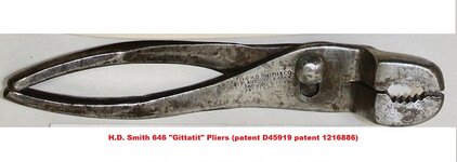

Lacking the teeth machined into the business end, those weird handles make me think of the "GettatIt" pliers made by H.D. Smith.
All purely wild speculation and conjecture, of course.
  • H.D. Smith 646 'Gittatit' Pliers (patent D45919 1216886) - H.D. Smith catalog pp 32.jpg
  • H.D. Smith 646 'Gittatit' Pliers (patent D45919 1216886)(Ebay 372530447568).jpg
