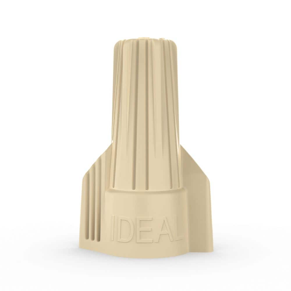

It'll be a whole bunch easier to shove everything in the box if you use smaller wire nuts. For up to three #12's I like the orange or orange/blue twisters by Ideal. When there are four #12's, the tans come out, the orange blues are rated for four #12, but don't fit very well. I don't use reds until there are five.
https://www.homedepot.com/p/IDEAL-Twister-ProFLEX-Mini-175-Jar-30-443J/320637277
Stay away from the red/tan or yellow/tan twisters, they are pretty much the same thing, one has a soft skirt and the other doesn't. They have the same range as a red wing nut but are at least 10% bigger, probably more. Those things are enourmous.

Thanks. I was just grabbing what was on top of my coffee can. I've got orange without wings and white and yellow with wings that are smaller than red. The red actually worked really good on both 3x12 and one 5x12.
This is what I'm working with...
The wingless orange nuts won't work, too small. The tans look like GB brand, I've never used them but they will probably work fine. The yellow nuts will work for three wires, I don't use yellows but know plenty of people that swear by them. The wingless yellow will give your fingers a workout, but get you by.
