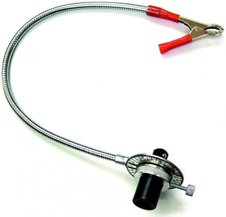

I can't tell if you're trolling or not. If not, I would use a 1/2" digital torque wrench. My Snap-on was really handy when torquing John Deere rod bolts to 55 lbs then 90 degrees. The final torque came to 194 foot lbs. Way more than any 3/8s goes to.
If you want old school, companies still make degree wheels and no batteries required.

Wright tool # 9L28100 (and mine still works fine after 2 decades):
I almost bought one of those once but I ended up with a new digital Snap-on torque that I traded truck parts I no longer needed and a Snap-on driver who needed them. Still might pick one up just as backup.
I bought mine around 1997/98. I don't use it much, but it is handy when I need it. And like you said before, battery life is awesome!!! Still using the original batteries......

Trolling? It's the head bolt torque spec for a Buick 3800 V6.
