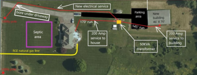

House is located in Bend Oregon, built in 1971, with a outdated 125amp Split Bus panel. I also have 60amps going out to the shop via direct bury line.
Scope: New 400amp meter/main service line from the Poco transformer + 200amp panel upgrade to the house + 200amp panel to the shop
Transformer to Shop
_ 30" deep trench from the Poco transformer to the corner of my shop ( just under the max pull length of 150')
_ 3" diameter PVC conduit with 3x Fiberglass 90's required by the Poco due to length of pull
_ 400amp metered panel on exterior of shop- 200amp to shop, 200amp to house
_ New feeder wire to existing 100amp panel in shop
_ New 60/80/100 amp connects for new equipment???
Shop to House
_ 24" deep trench from 400amp panel to exterior of house 75' run
_ 2" diameter PVC and 90s
_ New 200amp disconnect panel exterior mount
_ New feeder wire to existing panel location
_ Upgrade existing 125amp panel to 200amp panel
Old meter/buried lines/panel will all be disconnected and removed/buried
I have some questions about a few of the process and best practices.
Questions:
a) Looking at panel options, my PoCo requires a manual link bypass and Ring type - Any suggestions, leaning towards Square D Homeline or Eaton BR series unless someone can make a strong case why I should consider the QO or CH?
b) Im going to be running some heavy load machines that have 100amp start up demand then tapers to 50amp off a VFD also a 60amp continuous demand machine
_what is a good way to run power to these from the new panel, do I run a separate 60 and 100amp disconnect, or just a wall outlet wired to those breakers in the box?
c) see any issues with the overall system, blind spots?
Thanks

Awesome to provide the sketch! Many q's dont need to be asked.
Why 400 if you've living off of 125 for years? Wouldn't 320 be more than enough ($$)?
Go to to your POCO'S website and get their electric service requirements. It normally includes a list of accepted service equipment.
You probably dont need a combined meter/main and could be done as two cheaper parts....but check.
Glad you like the sketch, im a visual guy....
Not sure 320 is even a option out here? Plus the shop needs 200amps and the house can benefit from future proofing for EV charging or hot tub or mini split updates
Pacific Power my PoCo doesnt list approved equipment, only requirements - manual lever shut off and ring type meter
So something like a 200amp metered panel and a 200amp disconnect? Ill check on pricing

I installed a 320A meter socket on a free-standing meter mount which can support 400A max load 10' away from the pad transformer, located halfway between my home and shop. Each structure has a 200-amp load center. I'm not sure how the costs go with your POCO but for me they will supply the direct burial wire from the pole and the pad transformer. My POCO spec'd 42" trench depth from the pole to the transformer, back filled with 6" of sand POCO lays the wire in and then I back filled 6" of sand on top of the wire. If you place a pad transformer between your two structures your post transform runs to load centers will be much short and more efficient. If you POCO will cover the wire costs to the trans, that saves you money.
Here is my layout.

Good idea to split the difference on your property there. Some long runs you had to make.
Couple reasons I'm going w the plan above. Poco requires 150ft or less per run/pull and my shop corner is about 140' so no need for a new pedestal or new pad. Second is my property is pretty small compared to yours, and in a denser neighborhood. I'm trying to keep it as visually low key as possible.
Thanks for the idea tho. Looks like a nice chunk of land.

I re-read the PDF, its 2ft from edge of trench, still 30" deep
@Codyboy Really just looking to ease the install process since im cutting through 2 neighbors properties, minimal disturbance and downtime.
If I was in BFE and its only my land and my downtime wouldnt be as worried....
PoCo has final say in all this, if they dont like something, they can go Full Stop- just following the (51 page!) install manual
Crossing 2 neighboring properties to get to the transformer?
Hmmm. I see in another post you said 80% will be in a neighboring yard.
I don't know how it works where you are but here that would be trespassing. I'm not talking about you as a person trespassing, but your service line trespassing.
I can't remember the actual footage allowed but if it was more than about 8 to 10ft into another property and out of the easement was not allowed.
I'd probably get some clarification on that by talking with PoCo and not relying on a pdf.
dave*99
May 5, 2009
4,286
Coastal NJ
10ft PoCo easement so no trespassing, just being neighborly
I'm surprised there is a DIY option to trench in the neighbors yard within the easement. Even if allowed, I'd want someone else and their insurance to be the responsible party for that work.
When the PoCo replaced my underground service, I came home to find their contractor repairing two of my septic system laterals they cut through once the got on my property and took a short cut across the lawn. The transformer was 2 doors away and they had to install the cable in the easement along the sidewalk and cross under two driveways.
