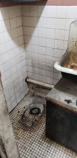

So I got a urinal, and I am going to mount it on this block wall. Under it is a vent pipe running horizontal along the wall, and a water pipe I will move. I need to plumb this into the 4" pipe in my floor that the toilet was on. This flange is sitting in poured concrete.
What is the BEST way to do that that will have as little bulk as possible and not require I chisel the pipe out? I think I am going to cover it with a little raised floor so I can stand right there. The urinal is 1-1/2" pipe. I went to my local hardware store, because I dont know what my options are here, and they were lost. The 4" pipe is 12" from the wall on center. I have no problem plumbing the urinal down to the floor there, I just am not sure the best way to adapt it to fit.
Thanks for the help.

More pics. I can also try to take the flange off that 4" pipe with a heat gun if it will make a huge difference. I cant figure out if I should bring that 4" pipe up to the wall or not. Or if my only option is to break the concrete under the tile.

Heres a thought. Flip the positions. Put the sink over the toilet drain and hook the urinal up to the sink drain. Not sure what you really gain by switching from toilet to urinal. Why not just put a small electric heater in the space set for 40 degrees? You will still need to keep supply and drain lines for sink and urinal from freezing with whatever fixture you have installed. I guess you could blow them out but that is a hassle. Also the hassle of having salt water handy can be a pain. Simple heater is lazy mans way.

If you want to convert the 4 inch to a 2 inch or 1.5 inch here is an easy way to do it. Get a piece of light steel or heavy plastic and cut it to match the outside diameter of the toilet flange. Put some toilet bolts in like you were going to set a toilet, probably all four of the openings. Drill the size hole you want and fasten the pipe to it via a coupling Let the pipe stick thru a couple of inches so it drains well past area. Now take a toilet metal repair flange and place it over the plastic or metal to make a sandwich and fasten it down. Or you can use tapcons and just fasten it down with them

So this is how I have it so far. I bought a PVC flange for a toilet, flipped it upside down, and stuck a ring between them the same as installing a toilet. Then I reduced the size and ran my plumbing. I am going to build a little table over it.
