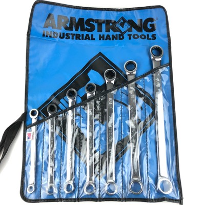

Are you looking for combination ratcheting wrenches or box wrenches? All the pictures posted in this thread so far are combination ratcheting wrenches not box wrenches.
I have Armstrong box wrenches in SAE and metric, they are made in USA. However, Armstrong is no more. Sets can be found on Ebay, just be aware if you go this route there will be no warranty.
I have a set of the Armstrongs and I also have a set of Matcos, which are rebranded Armstrongs - they are exactly the same. If you are concerned with warranty, Matco is still marketing a made-in-Taiwan set that I understand they would warranty a made-in-USA set for. The Taiwan versions are 90-tooth and look nearly identical and are probably really nice as well. HOWEVER, I will point out that if used "correctly" I don't think you would ever have a warranty issue. Use the fixed box-end to break the fastener loose, then flip the wrench and ratchet it off. And vise-versa for tightening. Minimal stress on the ratchet itself.
Pointing this out because they are for sure my favorite wrenches and they do come up on eBay from time to time, sometimes even NOS sets, and they will fall in the same/similar price range.
BTW, Apex will warranty the Armstrongs, but they will send out one of the XL Gearbox wrenches as a replacement. Not nearly the same (I bought a broken one to try this out and this was my result).
My 8mm is Matco, I could not find an 8mm Armstrong so I bought the Matco.
I also have SAE and Metric Armstrong ratcheting wrenches, both double box end and open end/box end combination. Made in USA. High quality in my opinion. Like jsmeece said, no longer made but still around on eBay

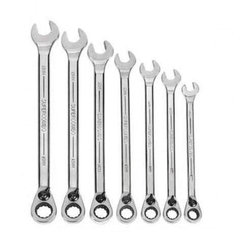

Williams!!!! Last I checked these are made in the US
Williams Supercombo reversible ratcheting set would be my recommendation.
WS-1170RCU​
https://protoolwarehouse.com/3-8-3-...ation-ratcheting-wrench-set-7-pcs-ws-1170rcu/
These are forged and assembled in the US. However the mechanism is imported. Its the same as the Williams/Bluepoint/CAT mechanism manufactured by Cendai in Taiwan.
The must have taken the gen one 72 tooth Snap-On design and sent it overseas because they look identical to my USA made Snap-On gen one set. Good to know however. It doesn't change my opinion on it though, they are very nice wrenches and the beam on Supercombo's is one the best i have held. The Taiwan made Williams ratcheting wrenches are also very well made and work great.
Or the Snap-on isnt completely USA made, even though it met the % requirement for COO. :yikes:

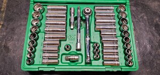

The spline-drive Protos... spline drive's reputation is worse than it merits.
Agreed. My most-often used 3/8 socket set is spline drive, and it's not even made anymore. I wish it was because they're awesome. The set was offered back when Facom owned SK, in fact it comes with a Facom-style ratchet (but still says USA on it).

The first gen snap on and the Williams (exact same mechanism) had the ratchet parts made in Taiwan. I had the snap on one and used the 9/16 one all the time as there is a lot of 3/8” bolts on cat engines.
the only problem with the first gen is the selector is prone to falling off when the screw backs out and you don’t notice it. I broke the little tang off once to. I have warrentied that wrench maybe 6 times in the last 15 years. They sent me the second gen last time maybe 5 years ago? And it is much more robust, all made in the USA and unfortunately a little fatter in the thighs.
