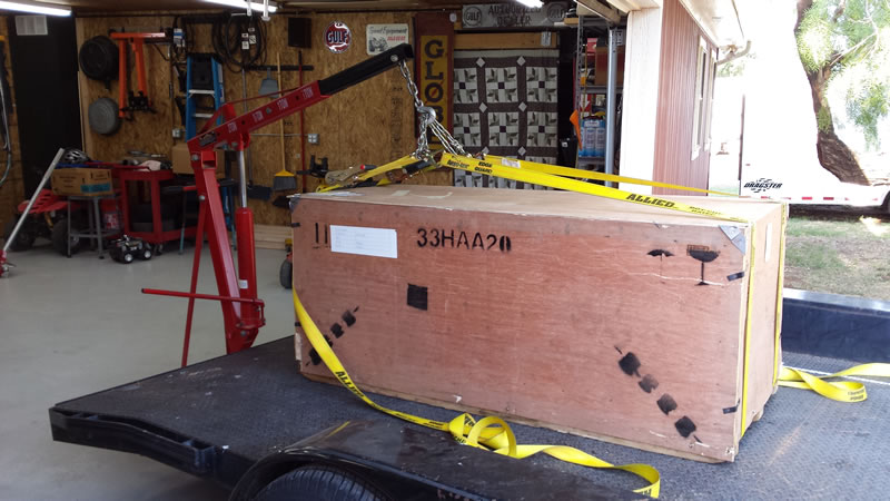

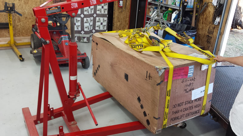

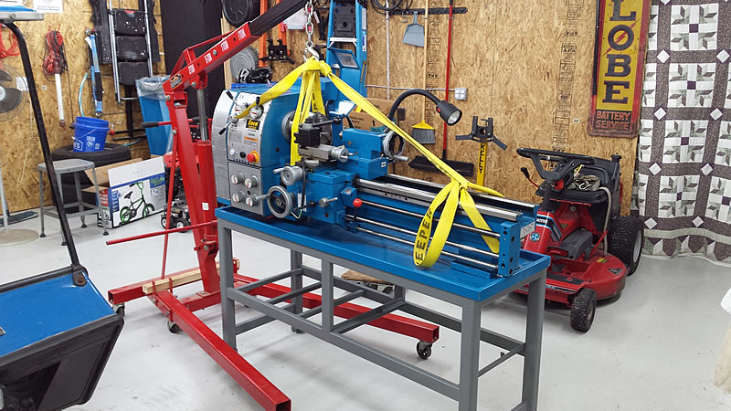

I modified my engine hoist for just that reason. I had to lift my lathe from the pallet it shipped on and this allowed me the clearance I needed.
