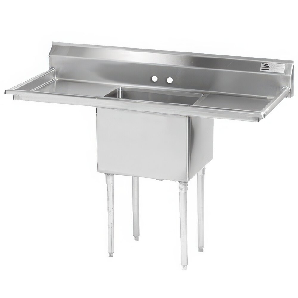

Smilodon
Oct 27, 2009
1,362
Titusville, FL
Ten years in, and I’m still moving things around to optimize how I want the space to function. Everything is “easy” to reposition as needed except for a sink, thus I would put it in a corner as shown. Having some area on one or more sides is indispensable, but I would put one in that has integrated drain boards on one or both sides, allowing **** you just washed to sit somewhere without getting water everywhere.
Yeah, I wish I had done something like that. My sink is nearly identical to those in shape and size, but without the drain board. It was even hard to find a sink at the time, and cost was a factor as well, but I do have issues with washing stuff and where to put it when it is wet.
Thanks, that's exactly the sink I had at my old place (18x18 with a side board). Two side boards is a good thought, I'll consider it. Like you said, I can't really change the sink location once the plumbing is in, but I still have lots of time to decide what sink to use.
LopezBart
Oct 13, 2023
2,582
Lopez Island, WA
We have a dual side board sink in our utility room, and love it. It's similar to this one. I clean the HVAC filters, the smoker grills, etc. here. The sideboards are very handy for placing things that are drying or waiting to be washed. The backsplash is screwed to the wall to locate it and protect it from tipping w/ heavy loads on one side.
Any chance you have a link for where you got the sink?
LopezBart
Oct 13, 2023
2,582
Lopez Island, WA
I'm not sure this is the place we got it from, but it's definitely a Advance Tabco FE-1-1812-18RL.
We got a faucet w/ a hose thread on the end to make it easy to fill mop buckets; with a concrete floor it's handy to be able to easily mop the kitchen, and the solarium has a floor drain that makes emptying the bucket easy.
Thanks for the lead!
