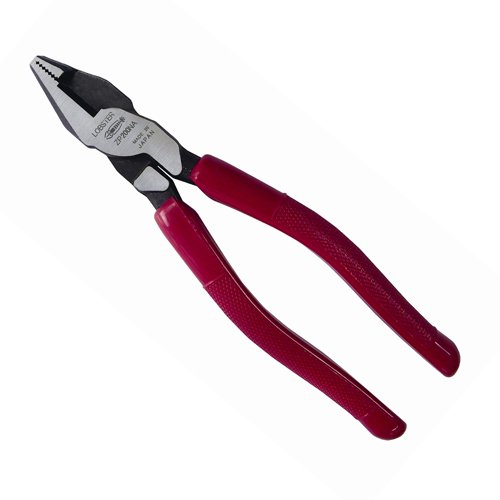

I decided on the Lobster pliers because of their size, which to me gives them the greatest leverage. They have cutters and are apparently the longest of the screw removal/extraction pliers; Amazon lists them as being 10.3 inches long. The $27.25 price at frank's tools is awesome: :
http://www.frankstools.com/losccuplzp.html
Makapuu,
You will enjoy using the Lobster pliers. I heard that it is a good choice among the screw extraction pliers.
The model ZP200NA is not 10.3 inches long. 210mm long is equal to approximately 8.25 inches. You're right that this Lobster model is the longest of all screw extraction pliers.
