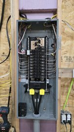

What is that panel fed from?
This - Had the socket on my house upgraded to 400a so I have 200a to the house and a seperate 200a to the shop. That way I didnt have to try to trench out from the basement and mess with the house electrical.
Well there's a whole bunch of other stuff your inspector should fail you for before he hits the boxes...

Gonna need a ground with that feeder, along with ground rods (I'm assuming it's a detached shop). Are your circuit grounds going to the neutral bar?

No, the picture he posted is a sub panel. Grounds can't go to the neutral bars, bonding screw needs to be removed. Needs ground rods (doesn't look like there's any for the meter/mains anyway, but ...).
He's got all the circuits made up in the panel, even if it's got a ways to go before being energized, it's still wrong and will have to be changed

I'm not talking about the pan and the 2 disconnects, I'm talking about the obvious sub panel fed from one of those disconnects:
