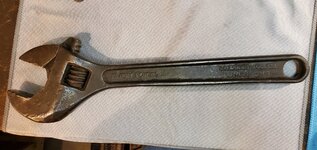

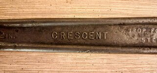

Picked up this 12 inch Crescent wrench recently and wanted to get some opinions on it. Real deal USA steel. Definitely one of the older ones with the really thick jaws (pre-Crestoloy steel). What sets this one apart is the fit and tolences are amazingly tight. Movable jaw fits so tight you can’t get a sheet of paper into the joints. Thumb screw is cross-knurled just like in the 1915 patent drawings. Also says “Patent Pending” on the handle. No way to know for sure but I suspect this may be very early in Crescent’s production. Your thoughts? Anybody have one similar to this?

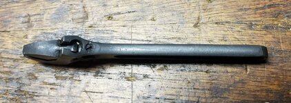

S
SilverDeck
Jun 7, 2016
481
More pics....

SilverDeck
Jun 7, 2016
481
Here is a pic of the 1908 engineering drawings for the Crescent Adjustable Wrench. The patent wasn’t formally filed until 1915, though.

S
SilverDeck
Jun 7, 2016
481
SilverDeck,
I have a few "early" (meaning, thick head, pre-Crestoloy) Crescent wrenches, but none of them have cross-knurled thumbscrews, and none of them are marked like yours. In fact, I didn't know there were any marked PATENT PENDING. I suspect your rationale for it being not just very early, but probably first generation, is very strong.
Nice find.
The cross-knurled screw really caught my attention because I had never seen that on a Crescent before. I was surprised when I looked up the 1915 patent and saw the cross-knurl on the drawings.

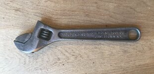

Username already in use
Sep 4, 2015
2,177
I found one back in October of 2016. Marked just like yours but the 8in version. Link to that thread is HERE. I had the same questions as you do. Nice find!
Here's a pic of mine:
S
SilverDeck
Jun 7, 2016
481
I missed this thread as well. Definitely looks like the “little brother” to the 12”. I assume yours has the same cross-knurling on thumb screw? I wonder how many of these “Patent Pending” survivors are out there? I’m sure many have been lost to attrition and hard use.

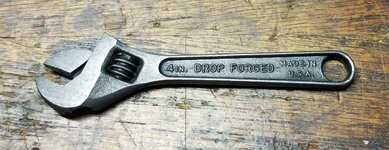

I've had a 10"crescent wrench that my grandfather gave me, niw, in 62,and he dies at 102,So,you have an idea ov how old it is, it was bare steel when he gave it to me, my dad blued it for be so now it's black, I am a heave equipment mechanic and that 10"crescent wrench works better that ANY snap on, Matco, oormac, spare, harbor freight or any other manufacturer, I took it up to odu in va to find out just Ole old it was, the year of manufacturer is 1920,it still like new, the damn thing is so good my son wants it he is 31 and works on kias
JaredP
May 22, 2022
9
Jamestown, New York 14701
I own one of the early 1915 Patent Pending Crescent wrenches as well.

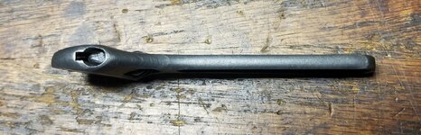

At body else have (or have photos) of an Crescent-brand adjustable wrench marked “Patent Pending”?
Besides my 1914-1915 Patent Pending Jamestown Crescent Brand Wrench, I also own this 4 inch "Jamestown, NY" "Made In USA" stamped adjustable wrench. I'm not 100% sure who in Jamestown made it but a former Crescent Tool Co Jamestown, NY factory worker told me that the old timers he spoke to at work years ago said that the first ever Crescent Forging (Tool) Co Jamestown wrenches only had "Jamestown, NY" "Made In USA" stamped and that'd he'd seen them come into the factory for lifetime repair or replacement while he worked there. He said my wrench is OLD. Like within the first few years of the company old. I'm still investigating it to be sure.

One other observation, @JaredP. Besides not having any branding, the COO marking ("MADE IN U.S.A.") is unusual for early Crescent production. As you know, because I see that you have one, Crescent was using the top side of the wrench for the branding ("CRESCENT") flanked by a size (OAL) and compositional marking ("DROP FORGED STEEL") and the flip side for the full company name ("CRESCENT TOOL CO.") and address ("JAMESTOWN, N.Y."). Decades later they dropped the redundant branding, centered the composition, and added the COO near the hanging hole, but put that on the flip side, using the top side for the "MFD BY" and full company name and address.
Why I mention that is because your wrench has the correct markings for a later Crescent adjustable, and in their correct respective locations, for what was being put on later production wrenches near the hanging hole of the handle. If you're following that. JAMESTOWN, N.Y. on the top side and MADE IN U.S.A. on the flip side. As if they had limited space and squeezed everything else off.
Or it's a novelty product?
Does anyone know when they added a 4-incher to production? The earliest Crescent catalog that I know of in the public domain is the No. 11, dated to 1914, on IA/ITCL, linked here. It's chock full of electrotypes, including the famously annotated one they used for the 1908 trade mags. It includes a 4-incher shown as having the same markings as the 8-, 10-, and 12-inchers above.
Does anyone have an early 4-incher? I searched the Crescent thread but didn't find any. I'll post some photos of my later one here for comparison purposes.
I wonder why the thumb screw would be off center in the 4" Crescent wrench?

New here. But I thought I would share a couple of my wrenches. I have yet to see another one like the 10” I’ve got. Note it says forged alloy but doesn’t bear the crestoloy stamping. Any thoughts on the age of it? I use it every day doing heavy commercial hvac. The 4 inches I just picked up today at a flea market for a couple bucks.Enjoy.
