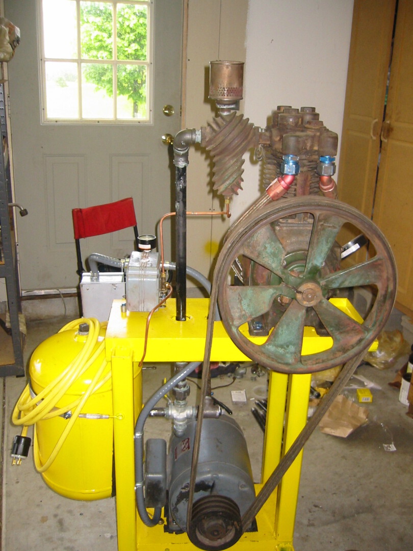

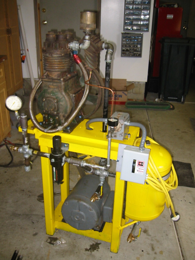

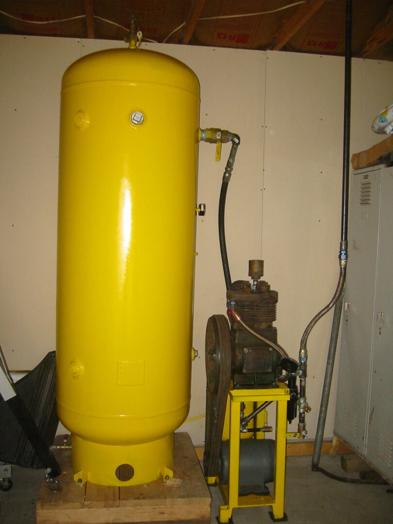

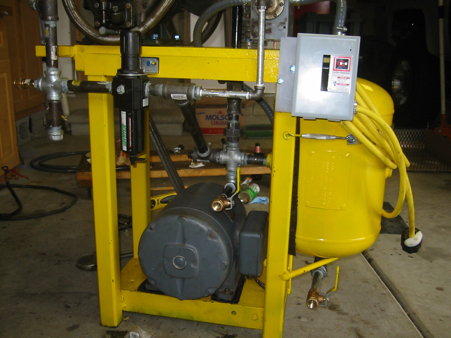

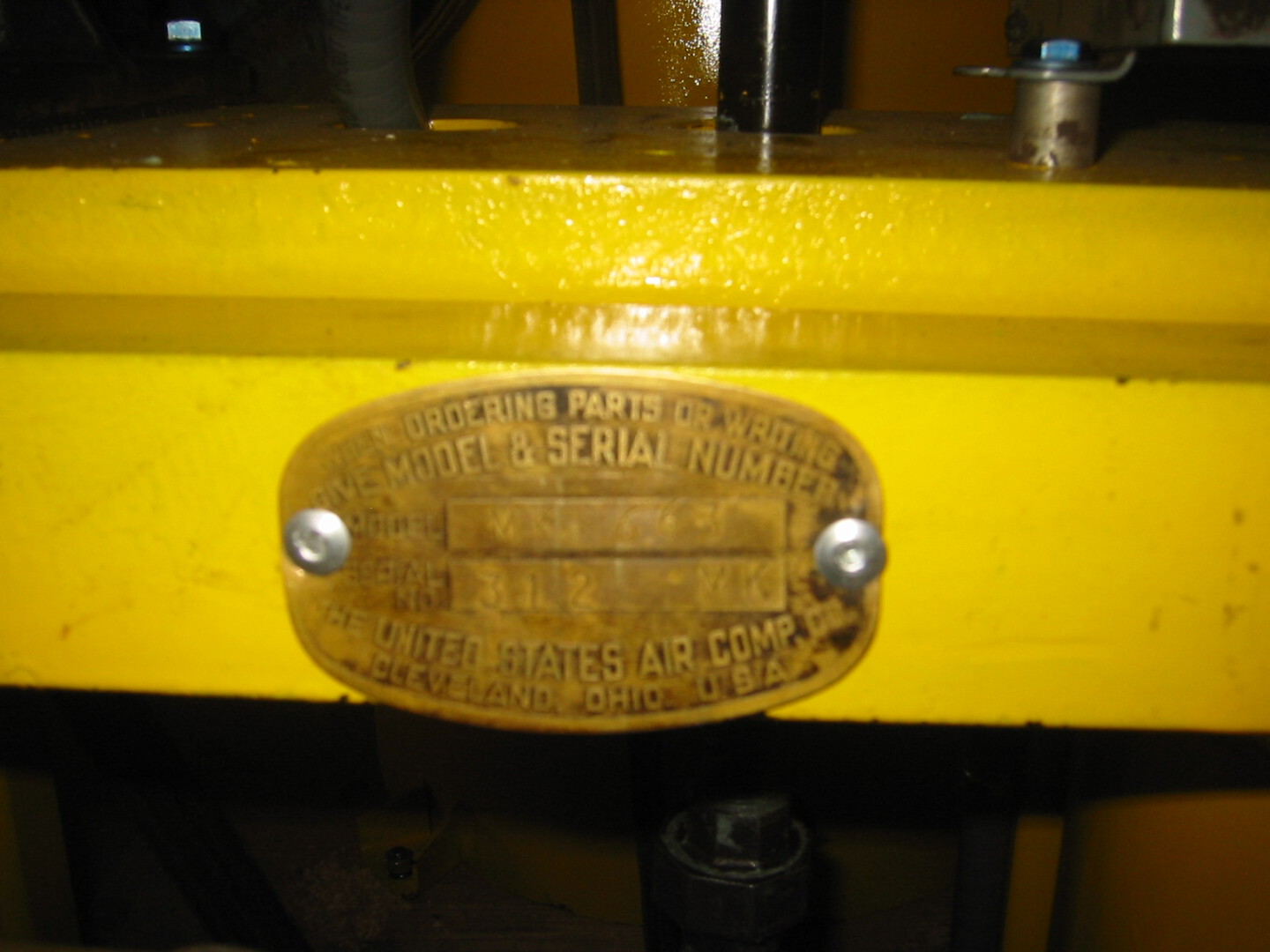

This is a 1934 US Air Compressor Model MK663
A friend of mine picked it up at a local sale and didn't want to use it. The 80 Gallon original tank was junk (although the original owner used it that way, rusted with a gasketed sheet metal screw in one hole). I built a new frame for the compressor, and found this 240 gallon tank on eBay locally for $100. Although to fill from 0-160psi takes a while, once filled the 120-160 cylce i have it set to fills in about 5 minutes. This compressor is a 3HP 13.5CFM rated. But considering todays compressors are rated more at peak than at load, I think in todays numbers, it would be "rated" higher. I'm quite happy with it's performance. Check out the size of that 3 horse motor. Todays' 6hp rated ones are 2/3 of that. The little 8 gallon tank there is a 'service' tank, so I can shut the main tanks valve and leave its' 240gallons alone, so I can replace the filter, fix any leaks (hasn't happened yet) in the lines, etc. I had to buy that thing new from a automotive plant supplier, because I couldn't find any 6-10 gallon 200psi rated tanks anywhere else. It costs just as much as the main tank!
The pics are from when I first aquired it and finished building the new platform for it. I've been using this as my main shop compressor for almost 10 years now and it works without issue.
(Click on the picture for full res version)
