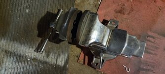

So once again, something I've never seen, even after scrolling through 1000's of pics of vises. Went to buy an enameling oven (to heat treat metal) which came with HUNDREDS of bottles of enameling powder and the tools whatnot to enamel any and everything and lo and behold there, on the floor, was a vise. A chrome vise. This thing isn't painted silver, this thing is chromed, almost certain of it. I took 1 crappy pic but I'm picking it up on Tuesday. I believe the model # is 2050 but I can't find a thing about a chrome vise.
Anyone? Bueller? Anyone?
PS Wtf are those jaws??

Nice looking vise.
Chrome plating would be flaking a bit where it’s chipped. Do you see any of that?
That shiny look might just be bare metal meticulously shined up with progressively finer abrasives. A scotchbrite wheel will get cast iron pretty shiny and then wax or Fluid Film would retard darkening.

I was too excited and didn't wanna show my cards so I didn't inspect and detect it, just said I'd prolly take it for a fair price cause I have another Columbian. $100 seems OK ya? Especially considering I had just scored at least a 1500° oven for $40.

It was a little old lady's craft basement. I don't think she had the equipment or the thought prolly to do all that polishing, but who knows! Will report and post better pics on Tue.

For a brief period Columbian made an all steel vise, the 804. That steel shines up almost Like chrome. But the shape of that vise is different.
These mounting tabs are unlike any vise I have seen.

Wow wrenchguy, that thing is gorgeous. I just can't see this little old lady going through what it would take to do that. But again, who knows? She was the crafter in the fam, it was told to me no one else was interested in the stuff, had to be hers. Maybe a leftover from a husband that passed, dunno. Will find out Tuesday fer certain.

If it's chrome, it might be a presentation vise. Or, it could be some guy worked in a chrome shop and had some time on his hands. A buddy of mine chrome plated the entire front suspension of his 1953 Chevy sometime in the late '60's.

So after some research, I may be changing my vote. It does seem to be polished. Reason I went to chromed was because it did look like some flaking where it was chipped. I dunno, can't wait for tomorrow tho. What y'all think about the price? I mean $100 seems fairish for any vintage vise that isn't ate up but I paid $30 for my other Columbian. They don't seem to be the MOST sought after but my jaw dropped when I saw it. I'ma get it either way just wondering if I should haggle some.

Most of the plated vises were jewelry vises and they were Nickel plated. Nickel is the 'color' coat over an initial coat of copper, then a 'flash' coating of chrome is applied. The chrome layer does not corrode or oxidize. Copper turns dark or green.
Nickel looks very close to a warm, slightly yellowish 'chrome'. BUT nickel does turn darker and gray-colored with time. It can be polished again, but shows fingerprints etc from the acids in our skin oils etc.
I suspect the vise is polished iron. Someone was bored and had some nice grinding wheels and polishing tools to play with.

I can’t remember exactly when, but this Craftsman, with the code 391 meaning cast in Japan) sold on eBay for a high price. It is polished, not chromed. See what you can do with patience, time, and various abrasives and power tools?
