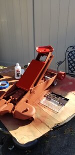

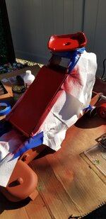

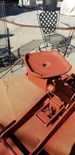

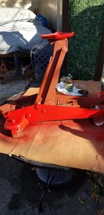

I got the rebuild kit however one piece inside the pump that i could not disassemble,,,or dont know how…finding another pump would be a option. Spent hours tying to disassemble…even had a millwright friend lending a hand but no luck. I will post a pic of the part and see if anyone has ever removed it,,last night i had a flashback or something. Could it be left hand thread,,not sure if i tried that=
I would really like to get the BlackHawk operable….

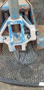

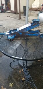

i have this old jack its about 31 inches long very heavy duty.has a solid square saddle about 5-6 inches Sq. only marking are on the swivel wheel caster holders stamped H628 also on the top of the handle is a aluminum knob that you twist to release the jack to lower.and on the fill plug is a metal screw plug stamped FILL..i. post some pics i cleaned it up and scrapoed all the rust off..its still works20200609_154702.jpg

can anyone i.d this jack it very heavy duty type of jack but i dont know make or model bought it like 30years ago from a shop that was closing up the guy said he thinks it was a sears robuck jack but he really didnt know.i dont think its a sears jack,i think its a blackhawk but not sure

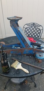

These are my 2 walkers. A 781 and I think a 884. The smaller one is complete. The big one is missing its cover. Both leak pretty good.

This is my Blackhawk s4 that I picked up. End up having to repair the casting on the light where something was dropped on it and cracked it open. Doesn’t leak, goes up and down but won’t pick up any weight.
