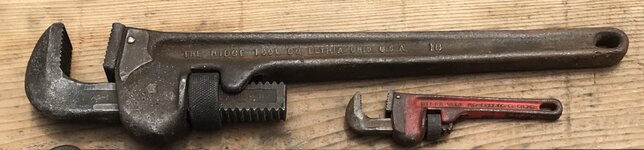

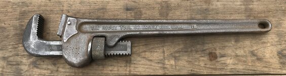

I found two Ridgid pipe wrenches at a parking lot sale a few blocks from home. I believe that the 18” wrench was made in 1931. The little 6” wrench has been painted red but it was made in 1944. It would be an acceptable GMTK 41-W-1660.
Don, as it happens I also have a 6-inch Ridgid pipe wrench with the same B-7-4 date code and it's painted red too, and scuffed to the same extent yours is.
Perhaps I've missed it earlier in the thread (or others), but weren't these wartime wrenches factory-painted black?
16,661
This one is the first wartime dated Ridgid pipe wrench with what looks like factory red paint. I’m still not convinced that it’s for sure factory paint. I checked really closely for any traces of the decal that it would have come with and couldn’t see any traces. IMG_9134.jpeg
A lot of years have gone by since the wrenches were made and a previous owner might have wanted his wrench to look more modern. I wish I could just ask the wrench!
Or plain steel.
The only thing I can think of that makes any sense to me is your B-7-4 date codes are April 1947, not July 1944. The month-year digits DO appear reversed (year-month) on some wartime wrenches, implying the diemakers were not completely consistent. There are a few examples on this thread. If that's the case it would mean they moved to red paint in 1947, not 1948. My comments on postwar changes (the recess in the adjusting nut, the round end of the dynamic jaw, and red paint) were all a little loosey-goosey, based on period ads and best guessing.
16,661
That seems like more of a stretch than just a repaint to me. I have more than a few wartime examples and this one is the first one I’ve seen that’s painted red or even shows a trace of red paint. GJ members are still painting early pipe wrenches red.😳
P
30,923
Granted, it's a very popular habit, mainly because of familiarity, but the finish on yours and Ben's doesn't seem recent to me and if they were ever black, that was stripped clean. Which seems like a highly unlikely coincidence they would have the exact same date code, to me. But, just a theory, we don't have to agree, and as you know, I'm not that interested or invested in postwar wrenches to begin with. I hope someone figures it out for those who are.

An intact decal would clinch the wartime use of red for me — did any get out onto the civilian market? — but I'm not trying to nail down a typology. I'll leave that to others with much bigger collections of examples.
For whatever it's worth, I have no intention of repainting the 6-inch wrench.
