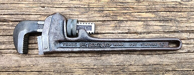

today's 5 dollar restore find - part of me wants to remove the dirt to expose the markings on the jaw, but the other part wants to leave the patina on the wrench!

And to judge by the knurled adjustment ring it's likely a WW2-made wrench. Cleaning the adjustable jaw may reveal a date...

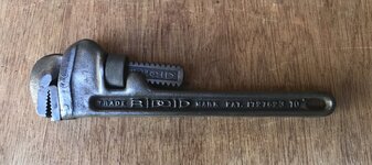

I love this thread. I found one, and bought it because it looks factory black. My assumption is that it was made in Octembruary of 1944 and wanted to see if you guys agree? (The adjusting screw ring would have to NOT be original.)

...wanted to see if you guys agree?
Yes.
Octembruary
Haha. Yeah, there are some numbers that bust the month theory. I have a couple, too.
Correct. Postwar interchangeable.

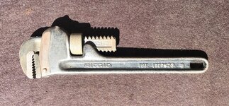

After looking thru most of the posts in this thread I haven't seen another one with "Pat'D" stamped on the handle ......I'm assuming it is probably dating between "Pat Pending" and the 1727..........Pat of 1929....any insight as to the date would be appreciated......

There are a few others on the thread. They've been discussed a few times. Jury is still out. See post #88 on page 3 and then posts #283 thu 291 on page 8. Or hang around. Yours might reinvigorate the discussion on them.

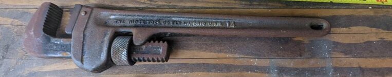

Thanks for heads up response to my post.......I've checked out the posts that you listed and agree that it is still a "gray" area. I will share that I have a collection of pre-48 wrenches from 6 thru 60......yes I know they should be black but hanging from my 12 foot garage/shop ceiling they are much more visible in red. I do have a few set aside that are still original black with decals intact.
