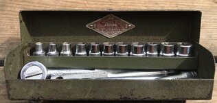

I found this S-K box at yesterday’s estate sale. Surprisingly, it contained a full set of New Britain sockets plus a breaker bar. The only S-K tool was the ever elusive crossbar. I cleaned it up a little. The interior is presentable but it will need a repaint on the outside. I filled it up from my spares.
It matches the 1953 catalog listing of a 4098 set. All 6 and 8 point sockets and the small diameter crossbar IMG_1426.jpeg

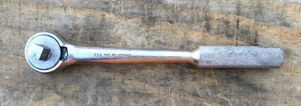

I have been reading through to research a 40970 I stumbled across and I just joined so I could post. I bought it because it was so tiny but it has the diamond logo and only the 1981526 patent number. I can't possibly be as old as the '40s can it? It looks nearly new! Did I miss something along the way and its a newer tool?
That ratchet was being sold from the end of WW2 until around 1963. They continued stamping that patent number on 1/4” ratchets through the Wayne period as well.IMG_9407.jpegIMG_9408.jpeg

Picked this up at the flea market for $6. Cool to see the original tray & leather handle. I know SK started the Brazil line in the 30's. Could this box date to the 30's? The leather handle has me curious....
Very rare and probably valuable. Mine was gifted to me by username. I believe that they used the leather handles until 1945. IMG_5693.jpeg
That is a particularly nice set probably made a short time before the WW2 metal restrictions went into effect. Here is the set shown in your 1943 Wartime catalog. IMG_2272.jpeg

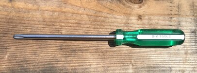

Looking for some opinions on this set I picked up the other day. I believe it is a 4921, but for the life of me, EVERY depiction I've seen of a 4921 set in S-K catalogs from Sherman Klove, Lectrolite, Wayne, Tools, to the newer stuff, plus ALL the actual pictures of sets on GJ and ebay have the standard socket tray on the right and the deeps on the left. I've looked through the 1/4" pages in most of the catalogs and have not seen this "reversed" layout anywhere. One detail I've noticed on the metal trays--as opposed to the plastic inserts--is mine does not have a short "keeper" wall extending down from the end of the std socket tray to keep the deeps in place.
Second point is the black & white graphics of the catalogs show a monochrome spinner. I believe Wayne used a clear green handle for their sets after the S-K amber and before the green and white of S-K Tools, and that should be what was included with this set.
