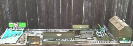

My Bay Area vintage S-K collection has outgrown it's medium sized toolbox so I spotted this box at an estate sale yesterday in Pleasant Hill, CA. Unfortunately, the price was a bit higher than I wanted to pay but this was the first one of these I've seen in person. Below are pictures of the new box followed by my home S-K collection.
-DonIMG_6370.jpgIMG_6377.jpgIMG_6372.jpgIMG_6371.jpgIMG_6028.jpgIMG_6027.jpgIMG_6026.jpg

Glad you found one, Don. It looks great. Will you have to reconfigure your Barcalo shrine in order to make room for it? :evil:
Congrats on the new SK box! I intended to stop by that sale but wasn't able to make it.
It looks like you have a few vacancies in your various socket sets. I have LOTS of vintage SK sockets - let me know what you are missing and I'll dig through my hoard.
The fact that your new S-K box is complete with tray and front cover makes it a great find regardless of what you paid for it. Grats!
Brian
16,670
Thanks, guys!
Notlob,
Thanks for your offer. After I get the sets transferred I'll have a better idea if there are any omissions. I found another Stiletto item for the bag of tools I've set aside for you.
Bill,
I'm just happy if there is a small path so I can get into the garage! The Barcalo shrine is hiding under the Jeep.
