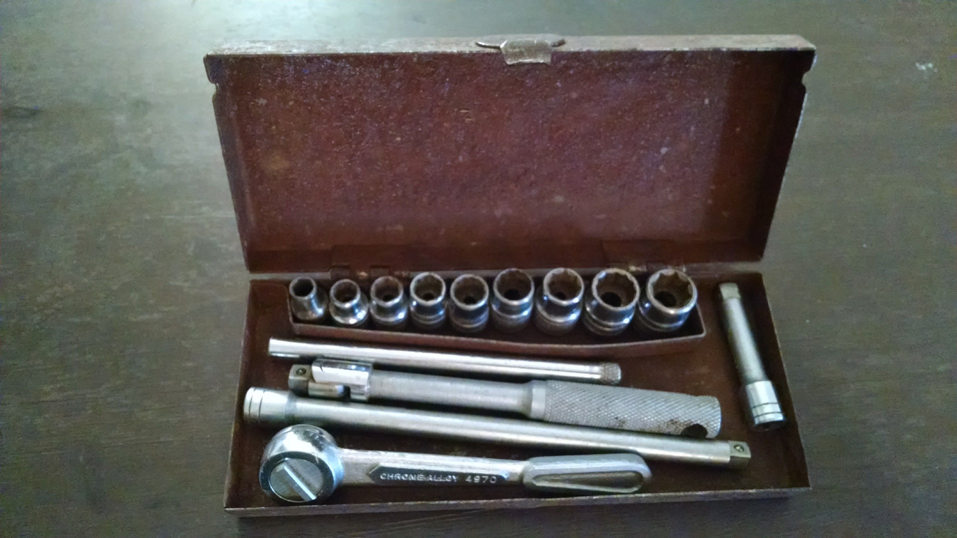

As first reported on the 2018 Garage Sale thread, I picked up what I am 99.9% sure is an SK Brazil midget set at my early bird flea market this morning.
The sockets are unbranded but unmistakably SK. The only marking on them is a fractional size stamping, which is in every case preceded by a single dot, also stamped.
No handles, but the pin handle was present, and it, too, is unmistakably SK, with that knurling on the end.
The box clearly matches the red Brazil boxes that CRTDI showed back on page 14, post #277, linked here.
The only slight reservation I have about claiming it as Brazil is the decal being too deteriorated to read. The general shape and the yellow border certainly matches the Brazil label, and the MADE IN CHICAGO U.S.A. on a ribbon-like border on the bottom is still legible.
CONTENTS:
- Cross bar
- 7/32"-12 point
- 1/4"-6 point
- 9/32"-6 point
- 5/16"-6 point
- 11/32"-12 point
- 3/8"-12 point
- 5/16"-8 point
- 7/16"-12 point
I guess I'll have to find another midget beavertail ratchet or swap the ratchet I have back and forth between this Brazil set and my first Brazil set for photo opps! :)

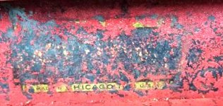

I see "CARU" as the first 4 letters but yeah, it's pretty fuzzy.

(I don't see much either, but whatever was written is in an arch I think...)

How many brazil logos were there? I have only come across this one , and it says clearing, ill.
Brazil Stamping leased in Clearing in May of 1930. The article I attached shows S-K consolidated Brazil out of Clearing in 1938.
I am no Brazil Tools expert, Otg, but based solely on empirical evidence (i.e., me fishing around in this thread…), there were several varieties of boxes (brown-ish, red), labels (banner, triangular), and addresses (Clearing, Ill.; Chicago, Ill.).
And some of them come with no decals, as my first set and bbrin’s
30,927
It looks to me like the red is painted over the decal, and that the original color was not red.
You could be right, notlob. It was difficult for me to tell. (I had already made a mental note that I would probably have to spray a clear poly seal over the decal remains it's so flaky there.) Based on how much bare steel there was directly under the red in most other places on the box, I didn't even bother inspecting it closer. But with your prompting, I think you could be right. I have detected a few places where there appears to be some yellow. I don't know how it would wear away from red to bare steel everywhere else, and it's a little odd to find a red wrinkle finish (more typically associated with a factory paint job than an owner's paint job) over an ostensibly original yellow finish, but, again, I did find some yellow. I'll let you fellas nut that over with some more pics.
Pic 1: Note the white triangle in the upper left corner. I wonder if that was an SK.
Pic 2: Even closer look in new light on label
Pic 3: Lid. Some yellow.
Pic 4: No yellow.
Pic 5: Some yellow showing.
Pic 6: Maybe a little yellow.
Pic 7: Same exact box as my Brazil set box, and you can see the yellow here and there.

Now I will throw a new and completely different hat in the ring.
I always thought I had pretty good eyesight (58 years old, still not wearing glasses, 20-20 last check-up a few years ago…), but twertsy, who sees a “CARU…” on the label, has vision that is apparently in US Army MOS 19D/Accipitridae acuity class.
I’m wondering if it’s a “CARB…” he is seeing on the lid instead. As in “CARB-O-MANG”!
View media item 85575
In fact, I am wondering so hard, I have dropped my BRAZIL TOOLS campaign and I am officially jumping on the CARB-O-MANG bandwagon. :)
There's no need for a cross bar in this particular set, but this was 1943. Who knows how many different sets there were in the 1930's.
Per GJ member Northwoods, in this post (#209) back on page 11 of this thread last year, “Carb-O-Mang”, an intentional allusion to carbon and manganese (tangentially, AISI 1340, which Herbrand used with great effect in WWII under alloy restrictions!), also appears in the last few pages of an SK catalog he dates to 1932-1933, and looks similar to Brazil Tools.
With TA down, I can’t check it out, and I don’t even remember if we had that one in our library. I’m going to ask Tin Medic if he has it.

So maybe 2 versions we know of, clearing Ill, and then chicago in later 30s? Carbo mang, that's a cool name for a socket set. It certainly resembles that ad.
30,927
Searches on “Carb-O-Mang” turn up nil. Searches on “Carbomang” (because hyphens are a search issue sometimes…) turn up many references to a new oil-hardened tool steel process in 1931.
My take-away is that SK inserted the hyphens for a few reasons. One, to distinguish it from the moniker for the steel process to avoid legal controversy, and two, because it just looks cooler that way! :lol:
30,927
Seriously, though, guys, I genuinely think twertsy nailed it with the "CAR" he saw, and both Outlaw and twertsy saw the arching letters. I am fully aware of the power of suggestion, and it's hard to overcome (i.e., in the same way you can't "un-see" something once you see it...), but I can definitely see it now, too. Especially with the decal blown up even more. You can actually see the serifs on the "C" and the "A" and you can see that the left side of the "A" is skinnier than the right side, like a fancier font.
I fooled around in PowerPoint with some serif fonts and sizes. This font isn't exactly right (a little too thin) and the serifs are also too thin, but it's close enough for comparison.
The "C", the "A", and the "B" seem to line up particularly well with their painted counterparts, and, while the painted letters on the other side are in worse condition, the right side of the "A", the "M", and the thick tangent of the "N" in "MANG" also seem to line up very well with the remains.
Is this representative of what you were seeing, Todd?
If you open the first pic and then keep alternating between the "Previous" and the "Next" buttons as you look at each letter, you can see it better.
