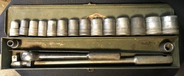

I finally found a 15/16” socket (along with a few others) on eBay that completes my wartime 1/2” drive set. I’m just going to ignore the missing crossbar for now. The last picture is a plain steel 13/16” wartime socket which is suddenly surplus.

OK, Don......
We are officially back on the rails. Are these sockets, new to my possession as of this evening, considered "wartime" SK? Also, is there a pricing premium for such special items?

16,661
OK, Don......
S-K immediate prewar and postwar were chrome plated, so when I see sockets like yours I assume wartime. Wartime S-K came cad plated, black oxide or plain steel. The first picture is a black oxide wartime finish and the second picture is of some postwar sockets. I haven’t noticed much price difference, just the wartime tools are harder to find.

Don (If I may), when you call that 13/16 a "steel" socket, I'm not really sure if that's a match to my set or not. Others have referred to mine as black oxide. Are they the same?
I'm very interested in that socket if it is indeed what mine are and you are willing to part with it. Roy was kind enough to hook me up with a ratchet and the other AWOL socket from my set. Roy's ratchet is the only drive tool I have. I'll be watching for those elusive T-handles.
No. By "steel" or "plain steel" Don is referring to no finish whatsoever. Just naked, natural steel. Black oxide was a finish invented in late 1941 as one of many alternatives to chrome-plating, which was restricted. Cadmium was in use on economy lines tools (as a price point alternative to chrome-plating) before the war, and its use increased dramatically during the war. Other Mfgrs dabbled with other alternatives (such as zinc phosphate), but plain steel, black oxide, and cadmium are the three main wartime finishes.

16,661
To expand a bit on Lugz informative reply (even though he failed to mention who came up with black oxide), cad plating and black oxide were not the most durable of finishes and in 2019 many of the wartime sockets have lost much of their original look and so in putting my set together I didn’t worry too much about finishes. I have put black oxide tools in evaporust and when they came out I ended up with pretty much plain steel tools. Lardy, you are welcome to my well used plain steel 13/16” socket if you want it or you can continue looking for one with the black oxide intact.
For clarity, you guys are speaking to tools which are marketed to the public, and not particularily "Mil Spec" or Military Issue" for GMTKs, right?
16,661
During WW2, the emphasis was on making tools for the war effort. Sales of hand tools to the general public, while not forbidden, was discouraged.

Here's my set again:

Lardy,
Hard to tell from pics sometimes, and I'm on a phone on top of it. Could be black oxide. Could be dark steel. Lots of 'unevenness' on your pieces and I can't tell if that's from box rot, patina or splotched original finish. In my experience, black oxide finish SK are unmistakable, and most of the pieces I have had the finish was very intact. But, they were midget drive, so, smaller and preserved in a metal case. I haven't collected much 1/2 dr SK to begin with, but of the pieces I have or have had, I don't think any of them were black oxide. The ratchet is steel.

I can see rust scale on some of them. Yes, they are splotchy. My Cornwell ratchets have a very similar finish. The black oxide that I'm familiar with has a textured finish. I guess any oxidized finish would. But I don't really see that in the sockets. More like steel with traces of something worn through. Maybe I declined Don's offer too quickly.

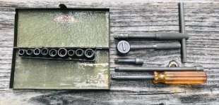

The offer still stands. Here is my absolute best darkest black oxide 1/4” drive set. Username has a very similar set. They must have been put away and never used since new.

Pulled this out of a bin of vintage midget spinners yesterday. The satin finish on the shank could be cad or maybe not, just satin. EDIT: I have not seen the marking white before, and it has a little slant on it. I am guessing 50's.

16,661
Haha. What do you make of the marking, Don? Or are some of your sets postwar?
I don’t have any with the white markings but I would assume postwar. They sold that part number right up to the S-K Wayne era. Actually the part number remained the same but the Wayne handles are solid green. I have some postwar sets that it would be appropriate for.:)
I had one with white lettering. I am guessing most had white lettering but it wore off. Either way those diamond era spinners can be hard to find. Well done. And they have a whole bin of vintage spinners!?!
30,923
I had thought about that (it wearing off) Roy, but the whole marking looks slightly slanted to me, too. I believe it was upright during the war. I moved my black oxide SK midget set on to another collector, so I don't have one to check. Perhaps Don can compare.
