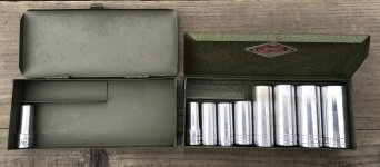

Here are a couple
16,666
Nice sets. I suspect that the spark plug set with the large water transfer decal was made around late ‘41 or ‘42, right before the chrome restrictions went into effect. The set with the riveted on plate looks like the one in the ‘56 catalog after the holes for the Ell bar were eliminated.

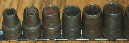

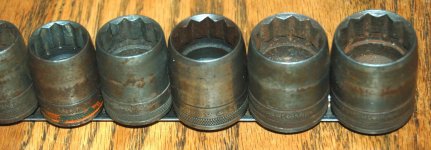

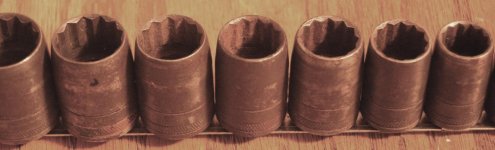

I had this box in the garage and it finally dawned on me that it looked kind of like the nice postwar 3/8” deep set that I got from Roy a while back. It was missing most of its paint so I sprayed it with some paint I recently found that matches the wartime S-K boxes, except for the wrinkle. When I tried some sockets in it I wondered about the empty space on the left side until I looked closely at the cover of the ‘43 catalog. I can’t tell from the listing but I think that the sockets may have been 12 point since they are more rare. The set would have had to be made in ‘41 or ‘42.
Nice work Don. I agree those 12pts. are more rare especially deeps.

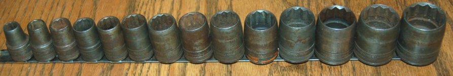

Thanks, Roy. I added all of the 12 point sockets I had to the early set. It looks like I am missing 3/8” and 1/2” deep 12 point sockets to complete the set. I found a nice 3/4” deep on eBay.
